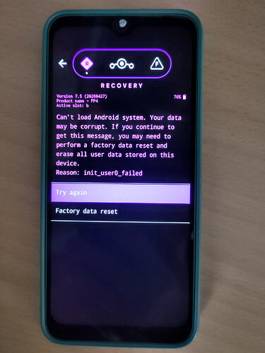

Can't load android system after update from IODE 7.4 to 7.5
after updating my Fairphone 4 from IODE 7.4 to 7.5 via the updater, Android cannot start anymore. Is there a way to start it again without a factory reset and losing all data?

I still did run into the “Reason: init_user0_failed” after updating to 7.5.
I tried to switch the “active slot: a” to “b”.
Entered fastboot, run `fastboot devices` on my laptop, which did not show a device
Then after a few reboots it switched to “active slot: b” but still failed, and with the following boot it worked fine and booted back to 6.14
