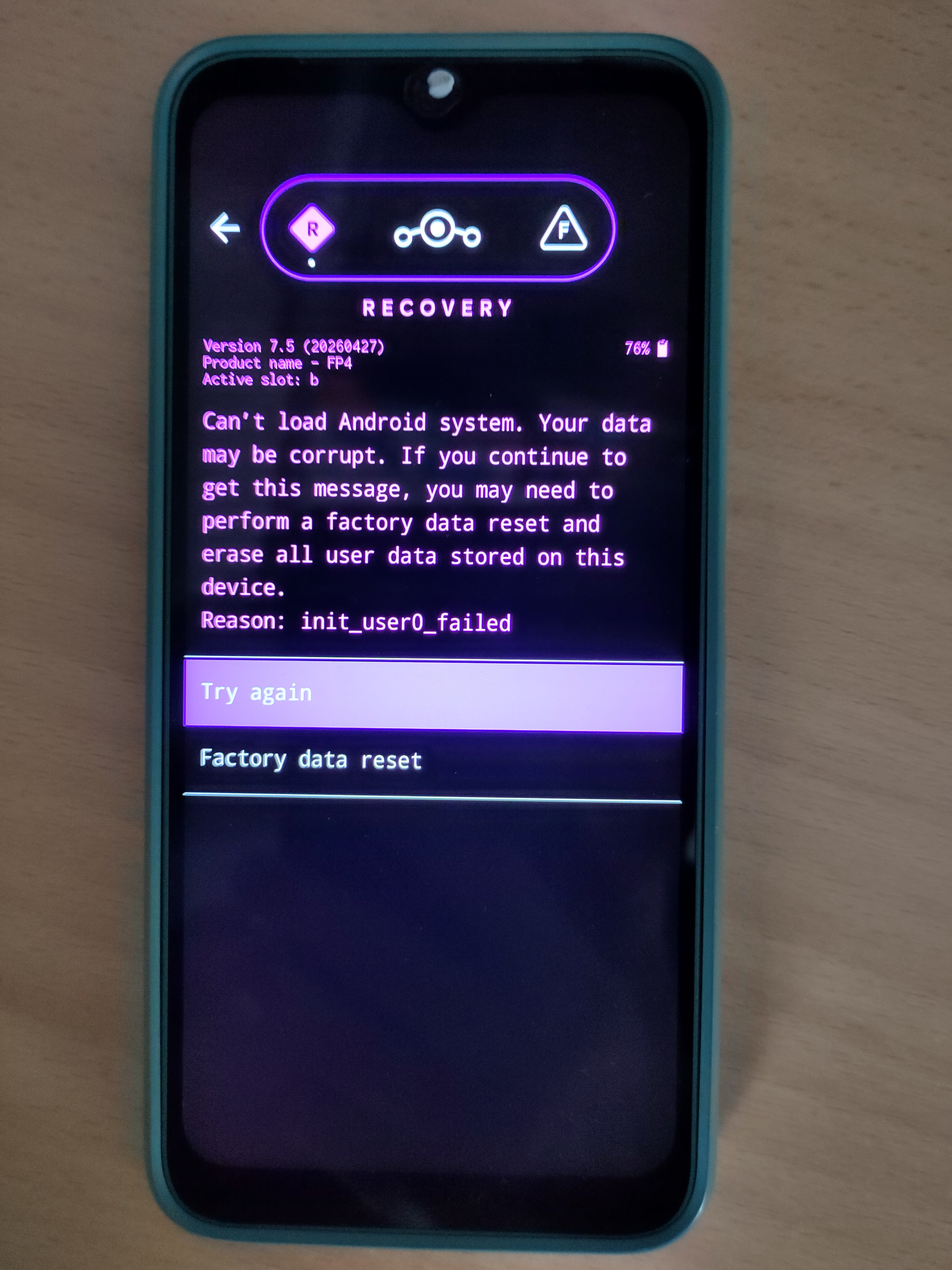

Updater delivered an update to 7.5 lately. After the update, my Fairphone 4 didin’t start up anymore. After several retries (approx. 5 times) it finally started 7.4 again, see
Other users had the same issue with FP6 and stock android. Hence it may be an FP issue. For the moment it’s not recommended to update a FP.

It is specifique, but not unique. I just had the same issue with FP4 and updating to 7.5.
For me it is a pretty serious issue if a regular update means the threat of complete loss of functionality of my phone. Because then I will only update, when I am sure I have enough time for a complete new setup in case anything goes wrong. Which means, I will wait even longer to update my phone. Which again, is a security problem.

Thanks for the report! So it is @wrongly-poet-cling and @andi that had issues. @wrongly-poet-cling did you get this similar message about init_user0_failed in recovery like andi?

Yes, I had exactly the same message.
And the bootloader was unlocked.
