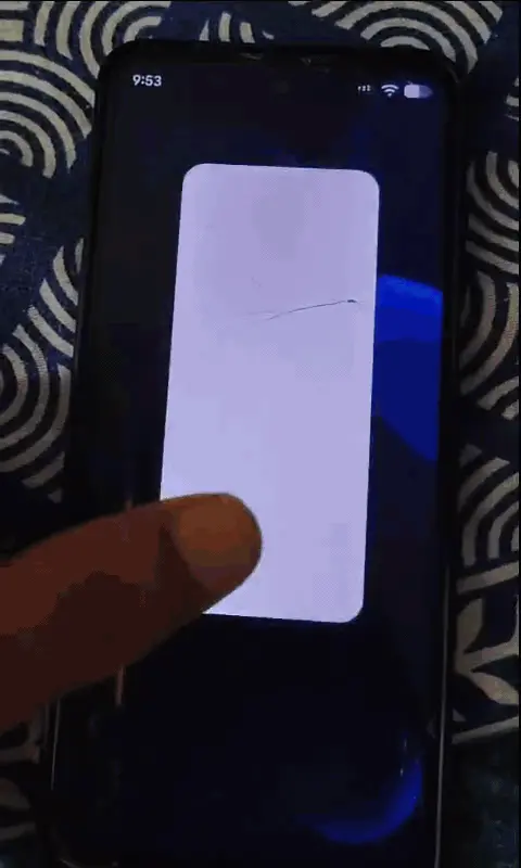

My phone is randomly rebooting since yesterday only when I use it not when idling. I also factory reset my phone but its still happening. Maybe it’s the latest update iode 7.8 idk.
New issue
Additional Information:
I have moto g32 devon 8bg ram. I have been daily driving iode os for a few months now. And it ran perfectly and none of this happened. But now its rebooing randomly
