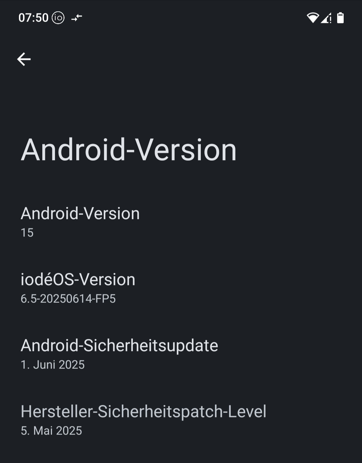

I figured now, that I want to check out /e/-OS or FairphoneOS (googled stock ROM) to see, if there is a hardware issue or this is all a bad combination of beta-stage issues.
After a bit reading, I fear that I am stuck for a while, since my android security patch level is on 1.June (with Android 15) while /e/-OS newest is on 1.may (and with Android 14)
The newest FPOS seems to be on 5.June (for now, and with Android 14)
But that makes it only worse to get it working with e-OS or later again with iodeOS, right?
Am I right with being careful not to under step the ASPL (patch level) ?
Do you know if downgrading from A15 to A14 would be a problem?
Thanks for any thoughts!

I guess installing the stock ROM will be the better choice for testing. All I found about downgrading on the web is that the security patch is relevant, not the Android version. But I have no experience with downgrading.
I am pretty sure that it will simply not allow install and give you a message to that effect, so it can’t hurt to try. You should be ready to clean wipe the device, however, as a “dirty downgrade” from A15 base to A14 base will not work well I think.
On a test device (Pixel 3a XL) I had iodéOS 6.5 but wanted to test something on 5.9. Even attempting to wipe in recovery and install gave me the “downgrade not allowed” error. But then I re-flashed the boot image with the 5.9 version, after which I was able to install 5.9 from recovery using adb sideload. I am not certain if it was the same block as before, so this may not be relevant.
