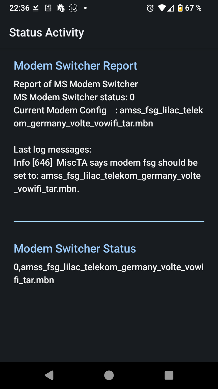

I also had this problem and appear to have solved at least the missing-modem-config part. After doing that, though, I still don’t have access to the VoLTE/VoWIFI options I used to. Could you attach screenshots showing where you have access to these?
(I see VoLTE and “WiFi Calling” in the Settings search results, but tapping either leads to the settings for my network provider and these settings are just not shown there.)
Hm, now I see that the MBN for my provider doesn’t appear to enable IMS.
This is how it looks for me. Settings → Xperia Parts → Status
VoLTE/VoWIFI is working.
Before I made the fix, there was only the default modem active and I also could not see others modems to switch to in “Modem Switcher Activity”. I noticed it was not working properly, because the phone always fell back to 2G for calls.
