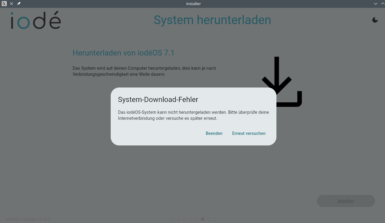

I’m trying to install iodeOS on my Fairphone 6, but after unlocking the bootloader the Installer fails download iodeOS 7.1 (“System Download Failure - please check your internet connection and try again”).
Internet connection works (downloading the flash tools in the first step worked like a charm). There are no error messages on stdout, and I didn’t find a log file. I’m on Ubuntu Linux.
I noticed that the installer is not (yet) compatible with FP6 (as of Offiziell von iodéOS unterstützte Geräte - iodé), so this might be expected. However, I also tried to install/flash manually, but I can’t even find the FP6 release on https://gitlab.iode.tech/ota/release .
How do I install iodeOS on a Fairphone Gen 6?

Fixed! You may try again.

Had the same issue here: Installer Donwloading Broken Config File
ah thx, thats probably the reason while it also hangs on windows, too - guess i will try it tomorrow then :slight_smile:
Should be fixed.
