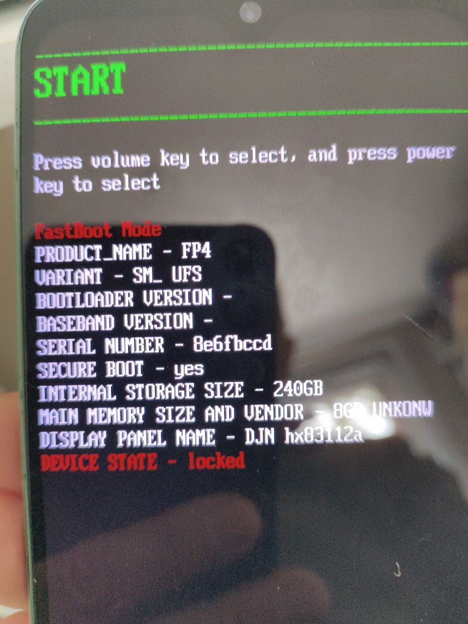

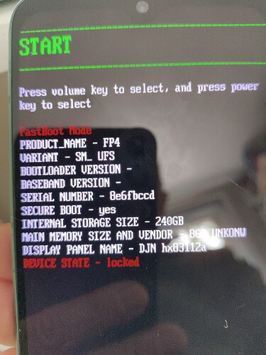

Il est en mode fastboot
Does it note “device unlock state” somewhere on the text of that screen? If it isn’t clear, do you have computer access to the device via USB cable? The command to issue to check is manufacturer dependent but you could try fastboot getvar unlocked. If that doesn’t work, you could do fastboot getvar all and then look through the output for something related to lock state. But again it should note it somewhere right on the fastboot / bootloader screen text I would think?

Je l’ai branché sur mon ordinateur. Comment faire pour qu’il apparaisse dans le terminal ?

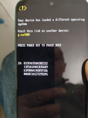

Ecran lors de la mise en route
This confirms your device is locked, so you will only be able to upgrade from 6.x to 7.x by backing up your user data, then using Recovery to do a reset and update application, or instead reinstall. Unfortunately, you will need adb or fastboot on your computer to do these procedures.
