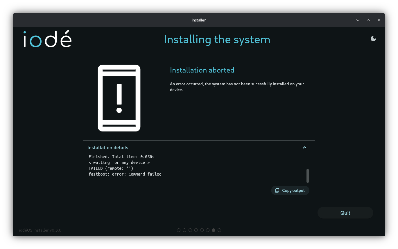

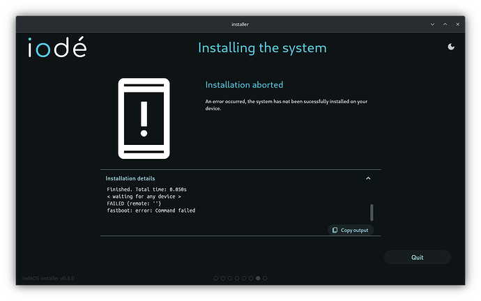

I’ve used the installer v0.3.0 on Linux to flash IodéOS 7.4-20260401 on my Moto G32 (devon).
As I’m coming from LineageOS, I came across the “OEM unlocking” issue, for which I’ve documented the workaround in this comment.
Do you recommend always starting from the stock ROM to install Iodé? Because Lineage makes that requirement explicit in its installation docs.
If I don’t quickly respond to the bootloader lock prompt, installation ends with an error, even though the system was successfully installed (with an unlocked bootloader) at that point.

Writing 'dsp_a'                                    OKAY [  0.087s]
Finished. Total time: 0.881s
Warning: skip copying fsg image avb footer (fsg partition size: 0, fsg image size: 18472960).
Sending 'fsg' (18040 KB)                           OKAY [  0.403s]
Writing 'fsg'                                      FAILED (remote: 'No such file or directory')
Sending 'hyp_a' (507 KB)                           OKAY [  0.012s]
Writing 'hyp_a'                                    OKAY [  0.012s]
Finished. Total time: 0.044s
Sending 'keymaster_a' (507 KB)                     OKAY [  0.013s]
Writing 'keymaster_a'                              OKAY [  0.008s]
Finished. Total time: 0.041s
Sending 'logo_a' (10544 KB)                        OKAY [  0.236s]
Writing 'logo_a'                                   OKAY [  0.051s]
Finished. Total time: 0.337s
Sending 'prov_a' (251 KB)                          OKAY [  0.007s]
Writing 'prov_a'                                   OKAY [  0.007s]
Finished. Total time: 0.031s
Sending 'qupfw_a' (75 KB)                          OKAY [  0.002s]
Writing 'qupfw_a'                                  OKAY [  0.006s]
Finished. Total time: 0.024s
Sending 'rpm_a' (507 KB)                           OKAY [  0.013s]
Writing 'rpm_a'                                    OKAY [  0.009s]
Finished. Total time: 0.038s
Sending 'storsec_a' (123 KB)                       OKAY [  0.004s]
Writing 'storsec_a'                                OKAY [  0.009s]
Finished. Total time: 0.029s
Sending 'tz_a' (4091 KB)                           OKAY [  0.094s]
Writing 'tz_a'                                     OKAY [  0.021s]
Finished. Total time: 0.134s
Sending 'uefisecapp_a' (2043 KB)                   OKAY [  0.053s]
Writing 'uefisecapp_a'                             OKAY [  0.018s]
Finished. Total time: 0.096s
Sending 'xbl_config_a' (251 KB)                    OKAY [  0.007s]
Writing 'xbl_config_a'                             OKAY [  0.018s]
Sending 'xbl_a' (5115 KB)                          OKAY [  0.120s]
Writing 'xbl_a'                                    OKAY [  0.054s]
Finished. Total time: 0.193s
Rebooting into bootloader                          OKAY [  0.000s]
Finished. Total time: 0.050s
< waiting for any device >
FAILED (remote: '')

Thanks for replying! I’m now running the stock ROM (Android 13), and it doesn’t have the issues I described, which I think rules out hardware failure. It’s got the very same apps, except microG, DAVx5 and all the other default LineageOS and Iodé apps.
By the way, this is what I see when I don’t interact with the phone in time to respond to the bootloader lock prompt. See screenshot below.
Maybe the installer could say that “installation has finished, but the bootloader was not locked”.
Well explained, I created this issue:
