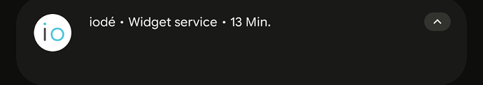

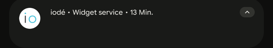

FP5: iodé app "zombie" widget service notification
I disabled the notifications of the iode app, however, every time I reboot my phone, I get a notification from the iode app with “widget service” in its title, but the notification is empty otherwise.
This seems to be similar to Iode blocker-app widget triggers notification every app-start since widget after one-time use
However, the linked Gitlab issue Making sure you're not a bot! has been closed for 7 months.
I tried resettings the iode app’s data (as suggested in Making sure you're not a bot!), but it did not help. The notification still appears on reboot.
Is there a way to disable this notification or is this, as suggested in the issues, a bug?
Difference to the linked issue: This is not happening on opening the app, but on rebooting the phone. The notification does not appear when I quit the app (or even force-stop it) and then reopen it.
Using iode 7.8 on FP5.
Thanks!
