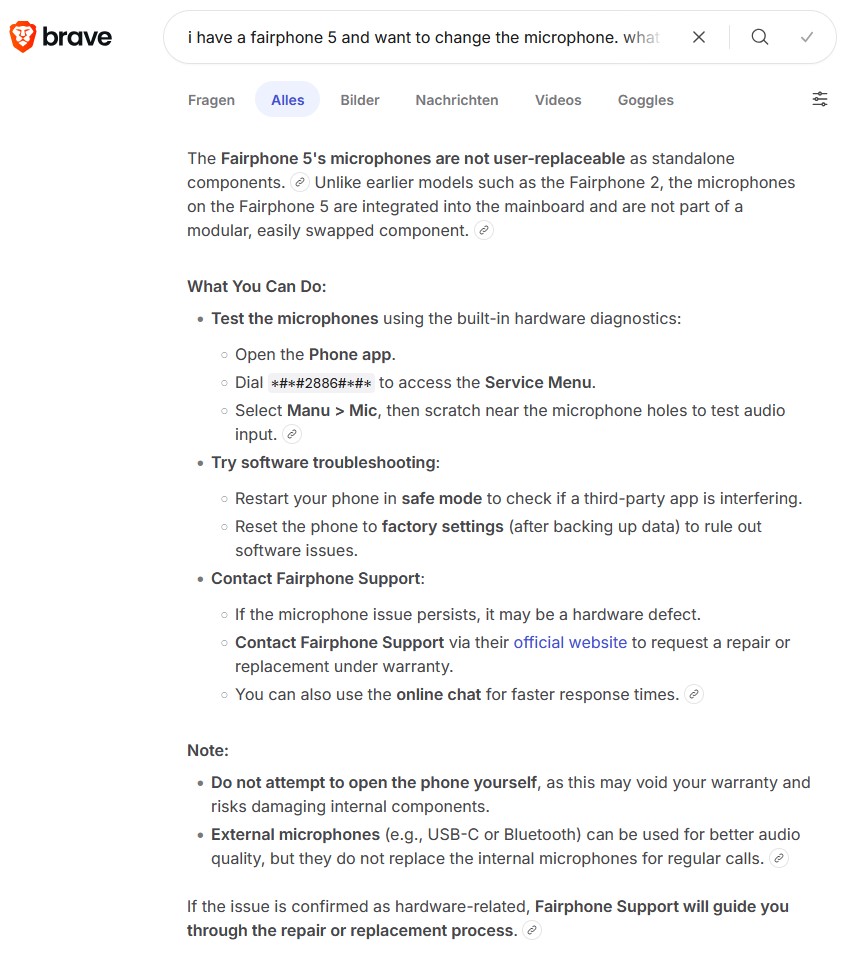

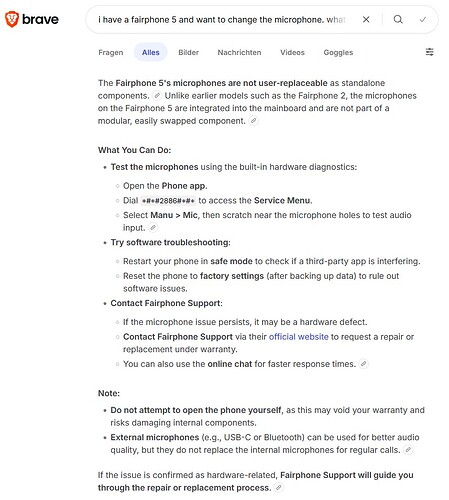

I don’t own a Fairphone and so I can only share what https://search.brave.com/ told me:
You could check the Topics tagged microphone to find out if it is possible for you to clean the microphone (voiding any warranty is not an issue for you).

I tried the “Service Menu” but the “number” does nothing.
I tried to install the MyFairphone app but I cannot find it on Aurora store ?!
