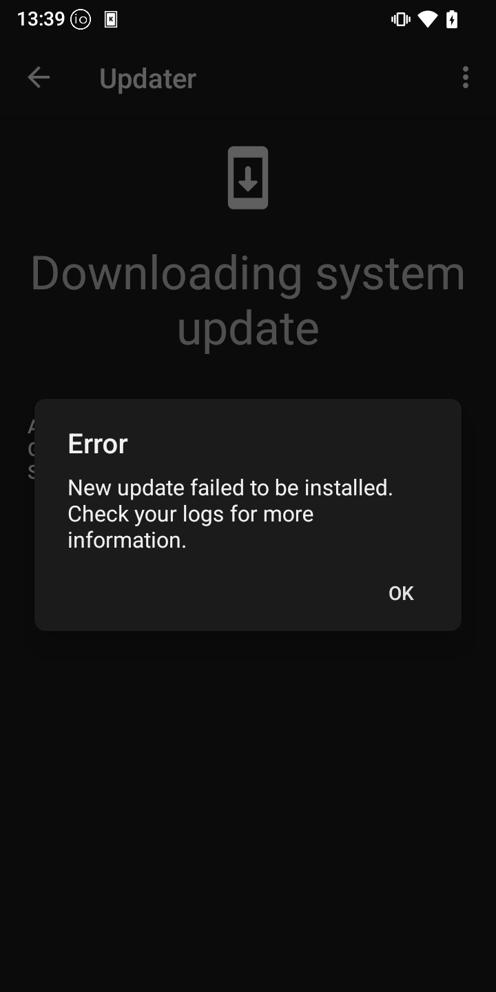

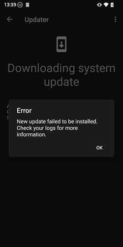

but could not find the answer to my question: the update OTA fails, and recommend to “check my logs”, but I don’t know where to find them!
I have the following sequence of events:

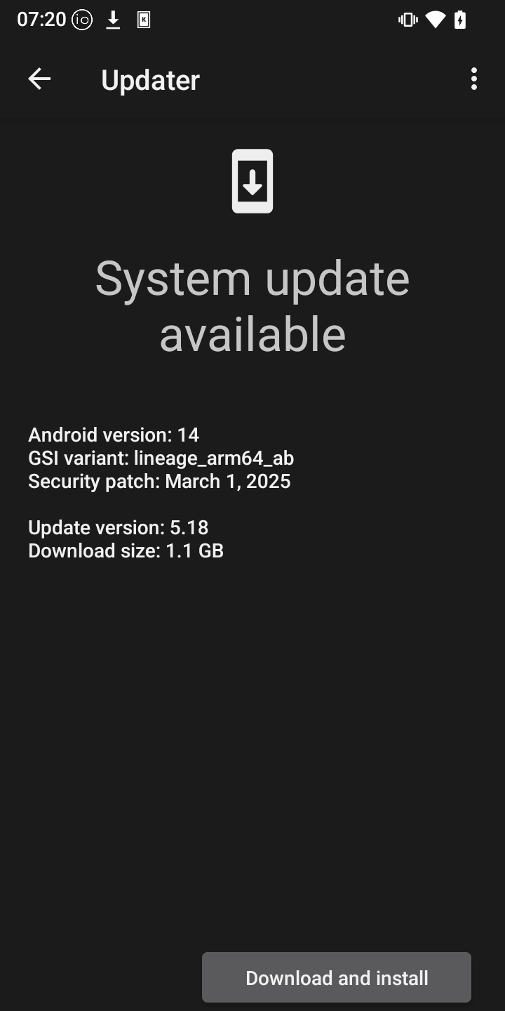

click “Download and install”:

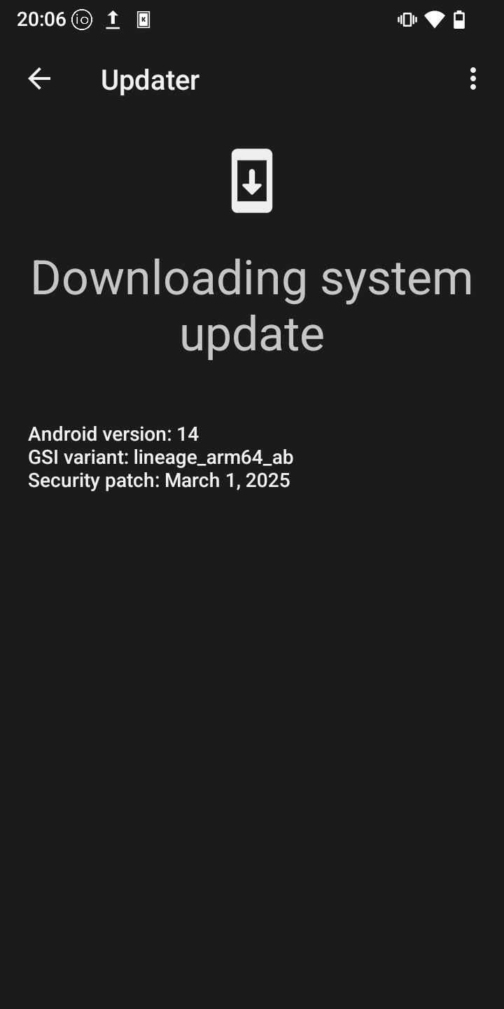

Then, after a while:
However, I’m stuck at this point, since I’m not sure where to look for those logs.
