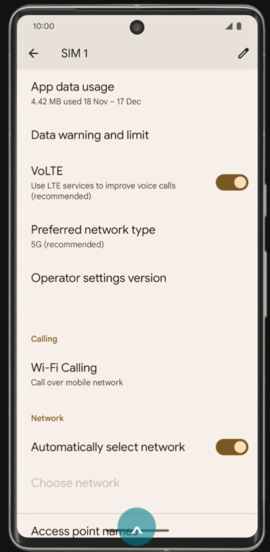

You have looked at SIM / APN settings? I wrote this up today to give a bit more detail on that for those that are not familiar with checking / adjusting them:

You cannot change the prefered network between 5G or LTE as it disapear after a few seconds,
No Volte option to turn on or preferred network type.
