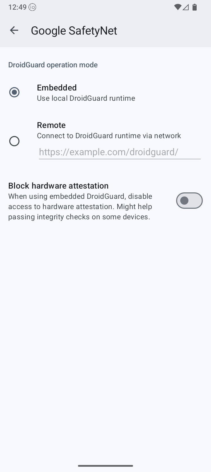

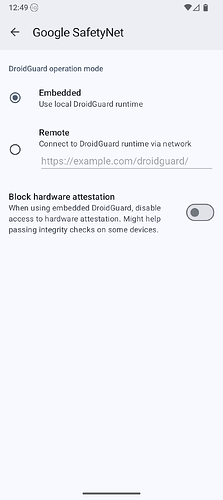

Hello, I am new here. Just recently moved over from /e/os on FP6. Swissquote app does not work. It fails to launch, citing ‘your device does not meet the safety requirements to run Swissquote app’ as a reason. It was working perfectly fine on /e/os as recently as 1 hour ago, so I am confused why it refuses to work now
Same problem with IODE on Brax3. Please help!
You have all the microG bits (Google Device Registration, all check boxes under Self-Check, “hardware attestation” under SafetyNet) enabled?
Also have you confirmed all permissions under “App Info” for the app are enabled?
Next can you try with the iodé app (blocker) disabled from its main screen?
Hello Rik! Thank’s for your response and your tips. Anyway no joy ![]()
Response: Make sure your device is not rooted or jailbreak, no virtuell PC.
As of Micro G with Brax3 no configuration possible on self-check .
All possible settings in Micro G enabled.
Only option as I understand is to use DroidGard to sign Micro G.
What is the procedure to do so?
Thank’s in advance for your help
Tom
Further to Rik’s advice this might also be worth a check / try…
Thank you for the tipp.
Result is now: After installation instead of “open” it say’s “update” and after that “status_failiure_invalid” App is installed but opens shortly saying “your device does not fullfill safty requirements” So obiously it needs more patience from my side.
Glad you got some partial progress, the solutuon may end up being the right combination of which microG settings are turned on and off - so might need some methodical working through all the different permutations.
…or worst case it may be there is just something obscure that microG doesn’t cover and the app needs?
