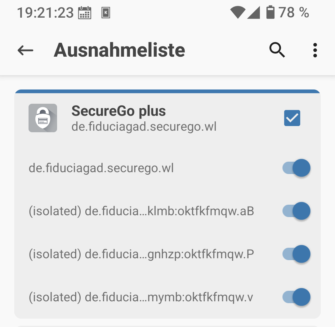

It works again, in the Magisk settings, I had to reenable certain addresses.

So please let me know: what do you mean with “reenable certain adresses”?
Maybe I will root my device again. (I use rooted devices since I owned my first smartphone.)
the isolated addresses had to be enabled again, then it worked
I know this options and I set them after every update of the app.
In my case this did not help.

I had to reenable the addresses again, but now I works
