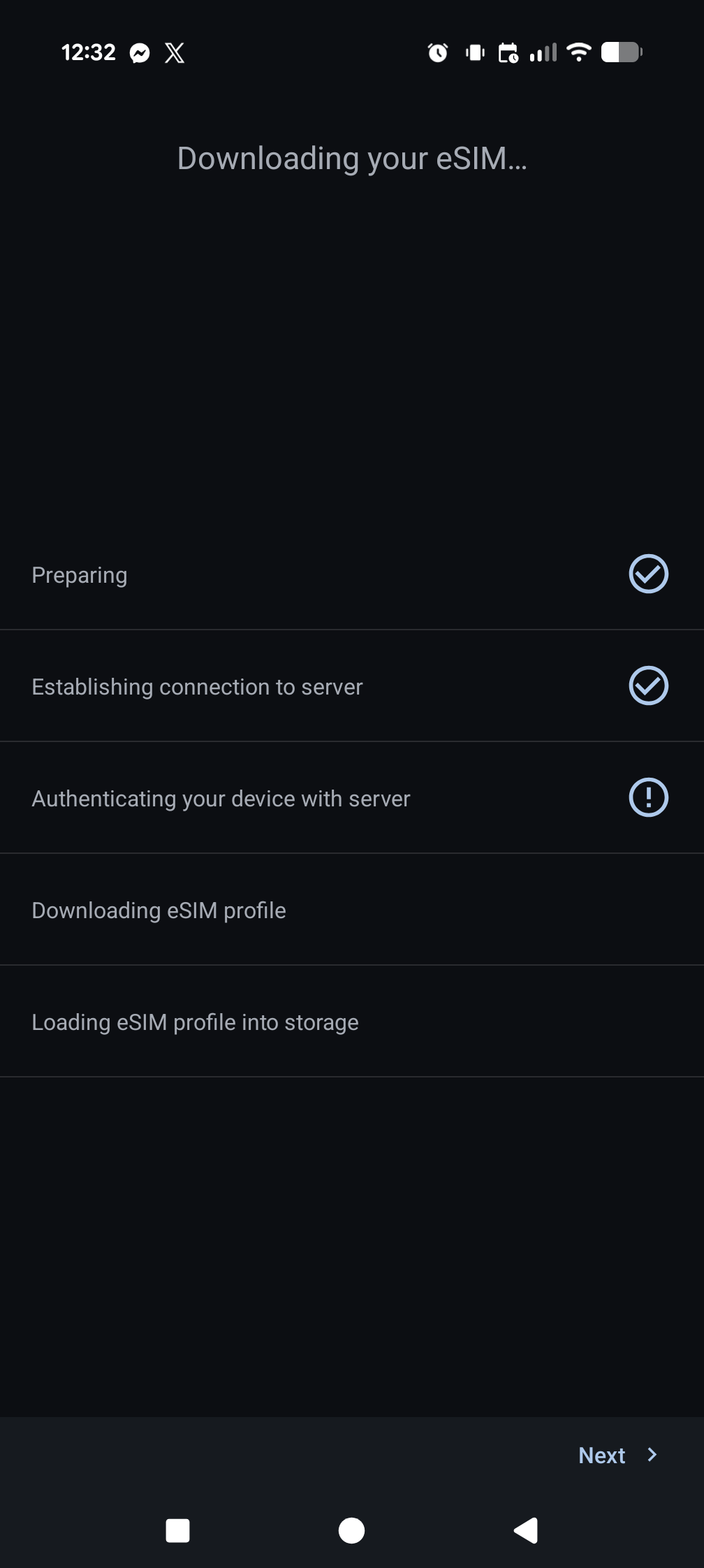

I am attempting to install an eSIM (via ATT) to my existing iode build Pixel 9 pro XL. I have gone round and round with the carrier for a month, and many different “fixes” from a few threads here with no success. Even obtained a new QR from the carrier. Cleared out all sims, physically removed my physical SIM and attempted to download… No changes.
I get to the authenticating your device with server and it fails there every time.
I am at a loss and out of ideas at this point and hoping someone may have some insight that I am overlooking? Dual sim IS checked in openEIUCC, it is up to date also. I tried different mapping of the sim slots, no change either.

I am not sure those are relevant to check, but not sure what else to suggest. Maybe send a screenshot (obscure any private info) of the failure?

Not sure if the Canada comment was to me or just from the other thread (which I have previously read through sadly with no success). I am on ATT in United States.
This is where I fail even with a second new QR code from ATT.

I see this entry in the log:
10-06 12:19:02.132 12020 12144 I EuiccChannelManager: Was able to open channel for logical slot 0, but the channel is invalid (cannot get eID or profiles without errors). This slot might be broken, aborting.
Maybe your mapping is incorrect, what are they currently?
I have tried numerous variations on it to be honest. 0 0, 1 0, 1 1. None of which have worked, but I am willing to give another shot. What are we thinking??
