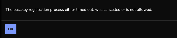

On my desktop, with Brave, when I try to add my Yubikey as a Passkey with community.iode I receive this:

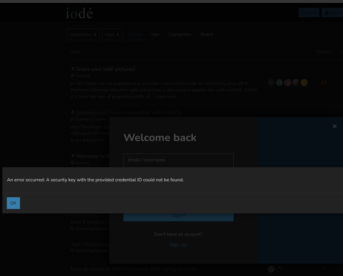

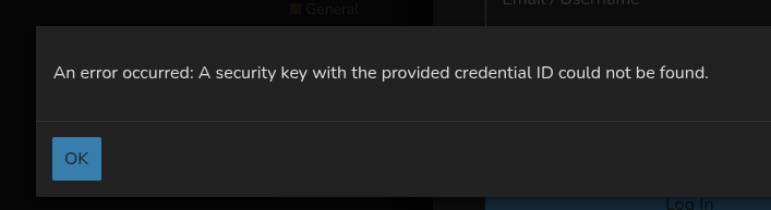

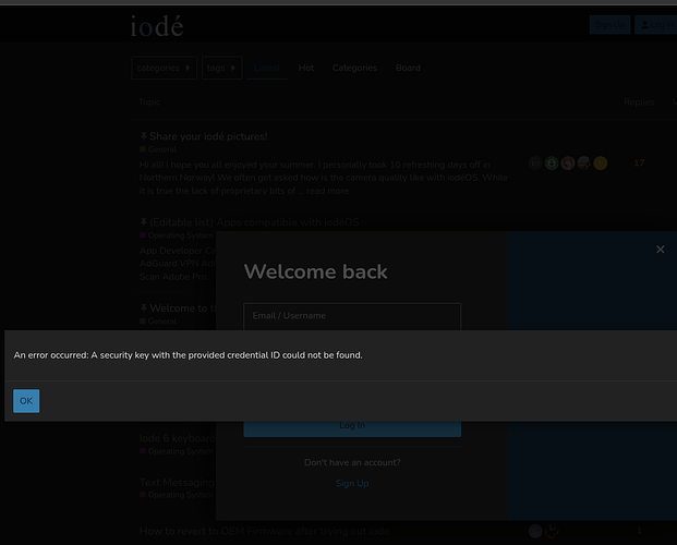

On my FP4 with iode, using iode default browser, I’m actually able to add my Yubikey, but then logins won’t recognize it as valid. Thats when I get this:

First… now I cannot get yubikeys to work with my FP4 and iode 6.1 at all. I tried removing and replacing apps, downloaded and tried all the major browsers (FF, Chrome, DDG) and none worked for adding or using (installed on my account) keys. The best I can get at the moment is for the browser to call the yubi authentication app, but instead of asking for a FIDO PIN, it always drops to the OTP page on that app.

Chrome and Brave CANNOT install a new key, but they can use an existing key that is already installed. When I try to install a new key I get that same message as I posted above (not allowed).

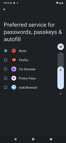

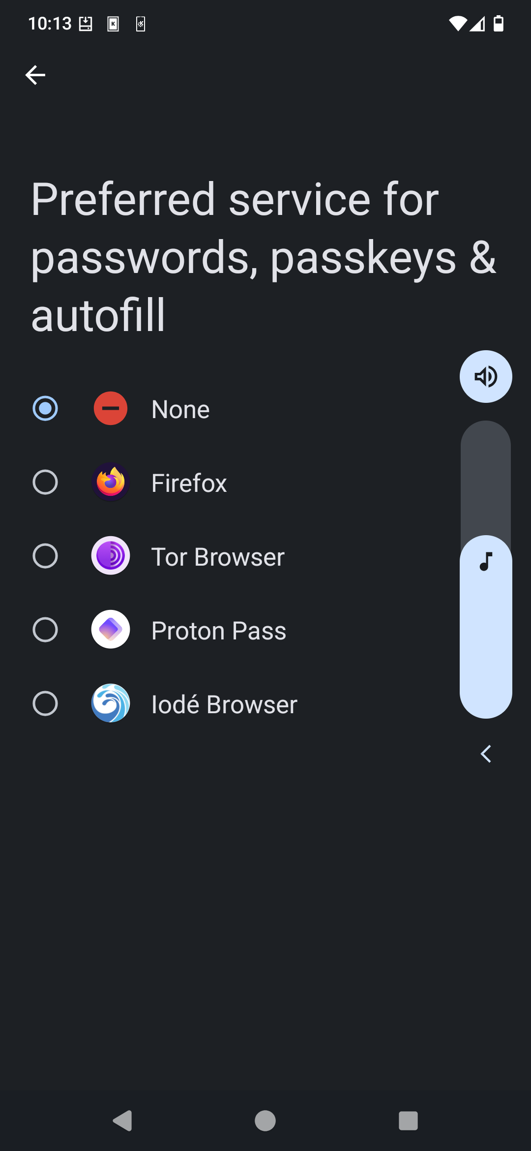

One note… on Iode under Settings - Passwords, passkeys and accounts, where you can set a preferred I don’t see the Yubi Authentication or even Chrome, but then Firefox and Iode show up, along with Proton Pass and Tor. I’m going to have to look into that, just to see what effect it may/may not have. I just found it odd that three browsers show, and the others don’t.

3. In iode Settings - Passwords, Passkeys and Accounts, is there a preferred app set? (mine is Proton Pass, and if I set NONE, then nothing works).
