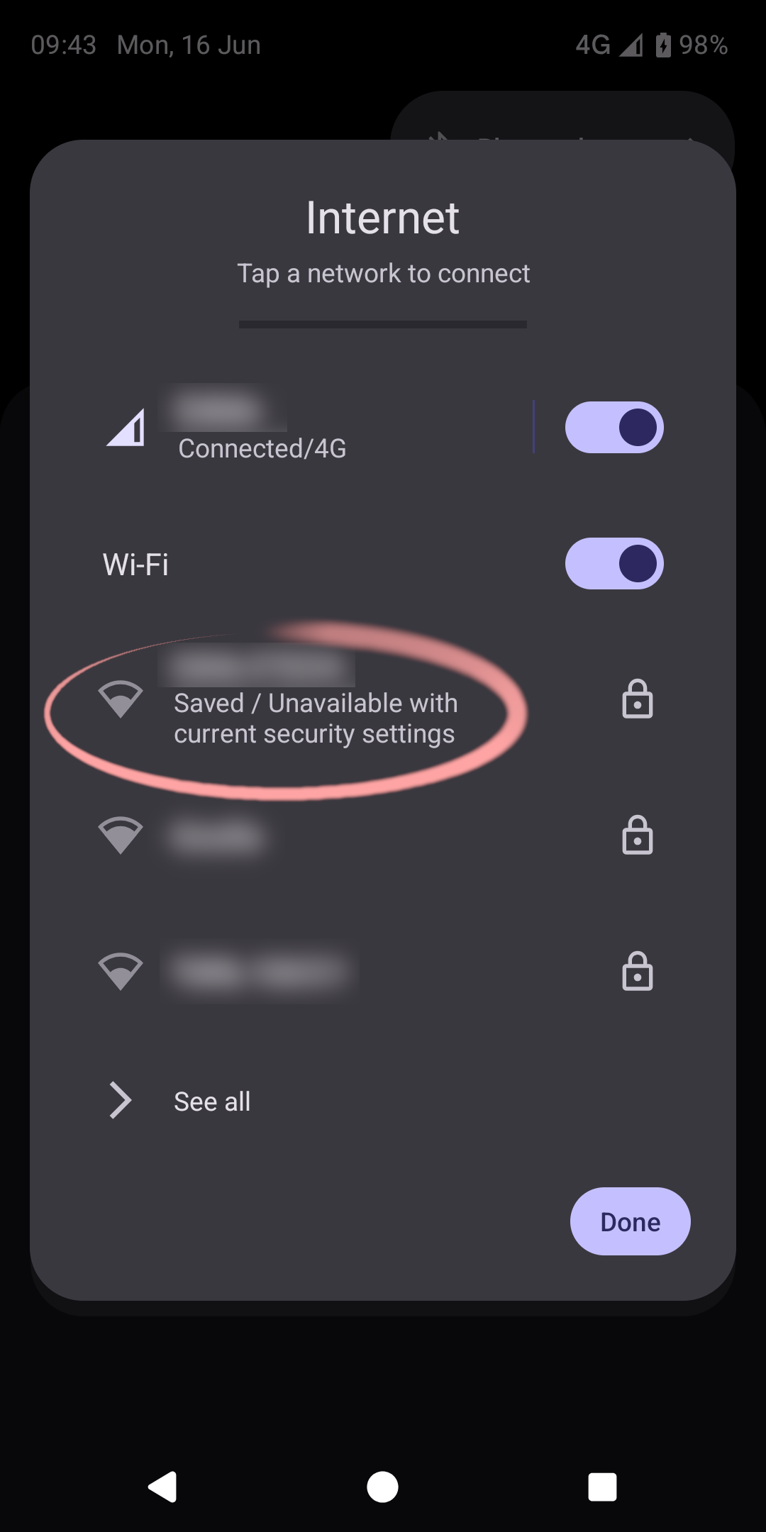

WiFi won't re-connect: "Saved / Unavailable with current security settings"
Hello! Thank you for iode and this community. I just installed it yesterday on my Fariphone 3+ and generally the experience is great.
One thing that is not working well is WiFi connection. First time I connect to my home WiFi it works, but after it’s disconnected, the phone won’t connect again. This is how it looks in the network connections view:
What are those settings? I tried to disable the “Connectivity check” under “Network and Internet” settings without any effect. The only work-around I found is to forget the network and connect again every time.

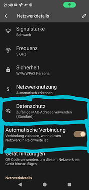

Tap on Privacy in the Network details setting
I don’t see the “Privacy” option in network detail :worried: I have three buttons;

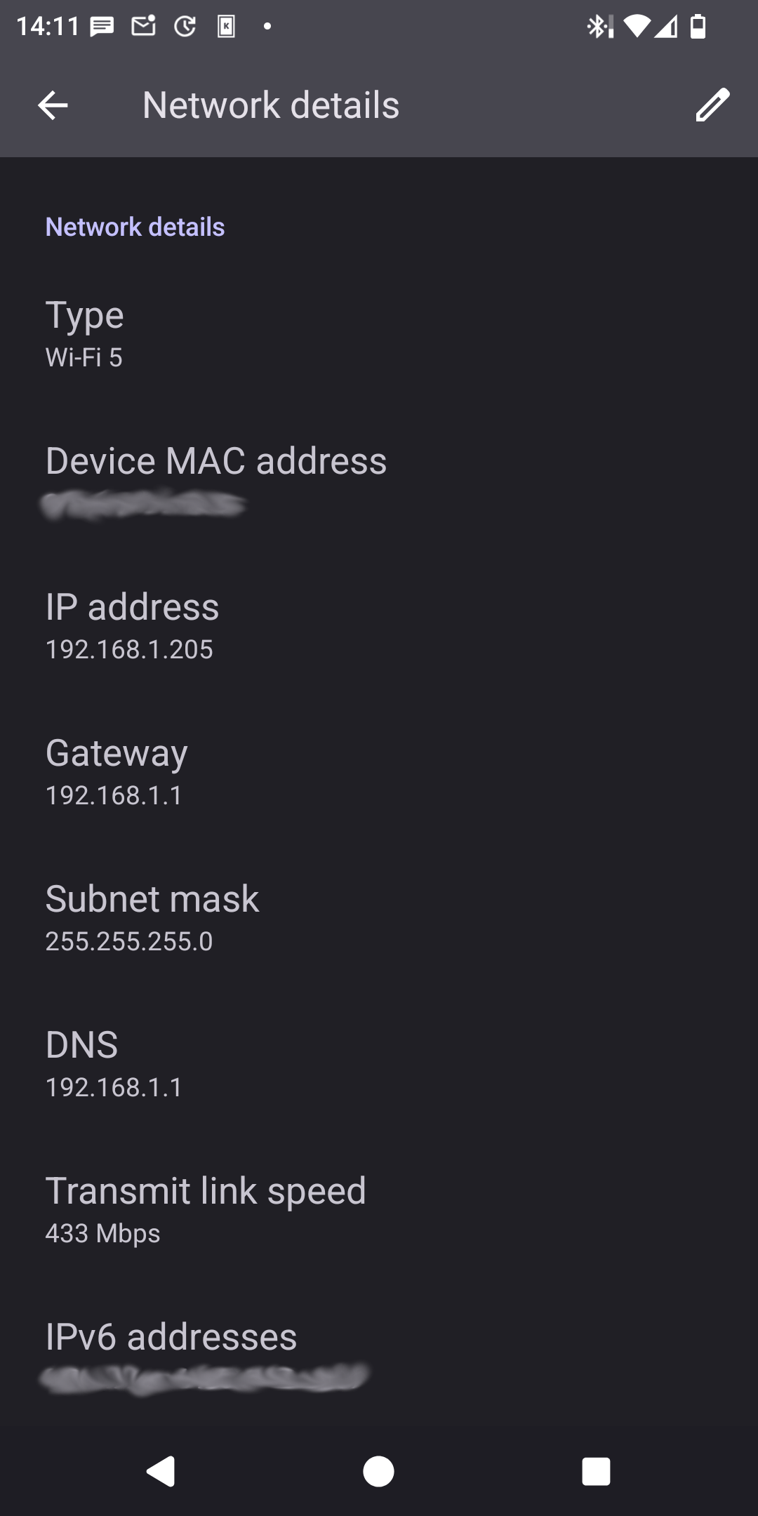

  • Type (Wi-Fi 5, but sometimes it was 4 and sometimes 6)
  • Device MAC address (just the address, not interactive except copy)
  • IP address
  • Gateway
  • Subnet mask
  • DNS
  • Transmit link speed
  • IPv6 addresses
There is also a little pencil icon in the top right corner. Here I can change the password, proxy and toggle DHCP.

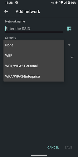

So I found some hits with your exact message, with a lot of Pixel users. Many of them worked around the issue by selecting the Add Network option, and manually configuring a new wifi connection. And many forcibly chose the options.
Maybe you could try manually adding your SSID with different settings, and see if you can get in. Here are the links for reference… dated, but your error message.
https://www.reddit.com/r/pixel_phones/comments/10gk4im/unavailable_with_current_security_settings/
https://www.reddit.com/r/pixel_phones/comments/z4xv2u/internet_unavailable_with_current_security/
Thanks. So those Reddit posts recommend 2 solutions. One is to downgrade network security on the router. That’s not a valid solution IMO. The other is to manually set security to WPA3-Personal on the phone. This seems reasonable, but I don’t have the option! There is only WPA2-Personal or WPA3-Enterprise. I don’t think my router supports the enterprise variant.

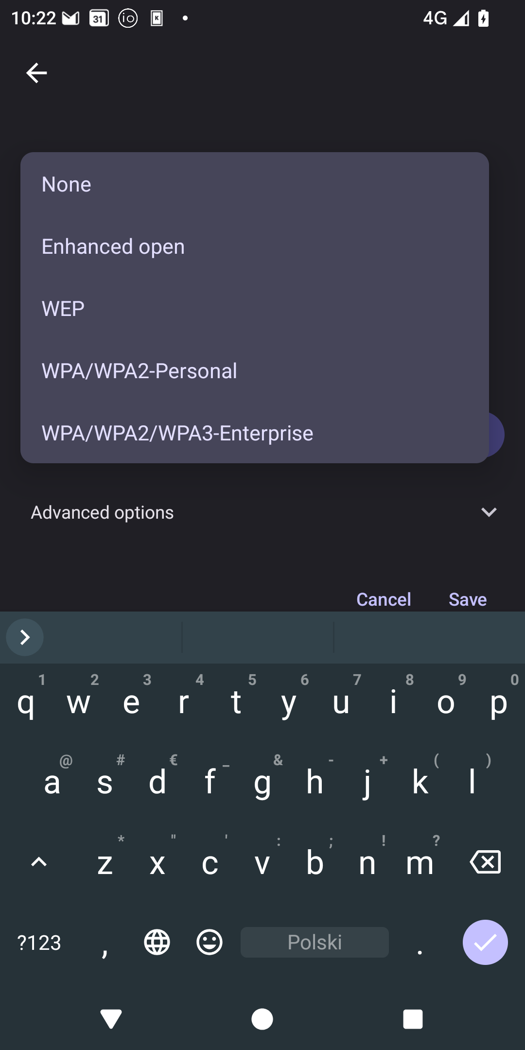

Thank you for showing up for me :smiley: I’ve just tried it, but unfortunately I don’t have the WPA3 option. I only have:
  • None
  • Enhanced open
  • WEP
  • WPA/WPA2-Personal
  • WPA/WPA2/WPA3-Enterpries
Perhaps this is the core issue.

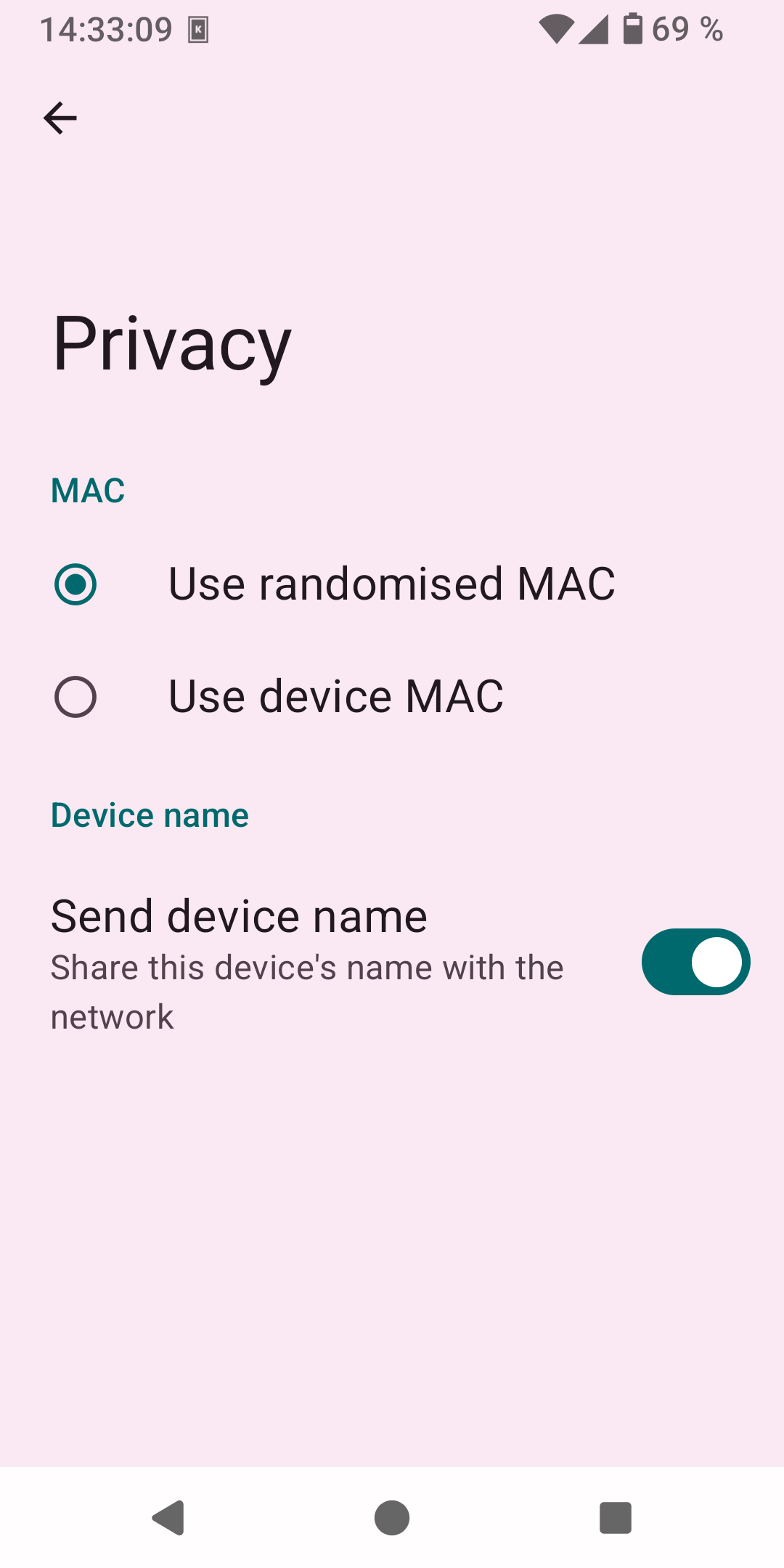

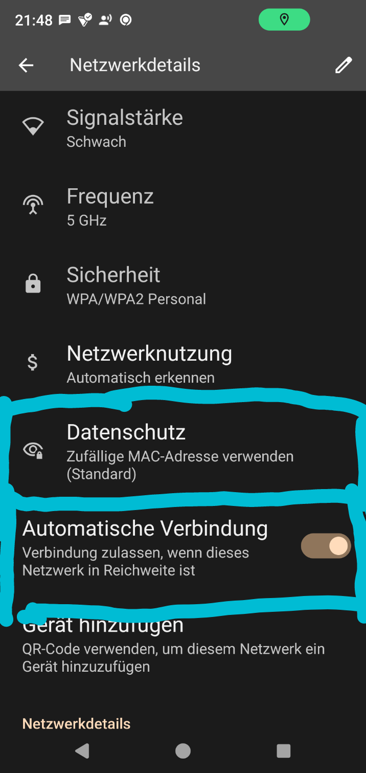

Not certain it is the issue, but you can disable MAC randomization by clicking the “gear” next to your connected wifi network and then go under “Privacy” and select “Use device MAC” instead of the default to “Use randomized MAC”.
Thanks, but I don’t have the privacy option.
You should have. Go to your wireless connection -Settings - then:
Edit: Randomize is the Default, in normal way, this correctly.
Sorry everyone is going around in circles trying to help you. But your notes above show that you are indeed using your “Device MAC address” (that is the display only output you show, if it were randomizing it would show “Randomized MAC address”. So this in itself is not the issue.
