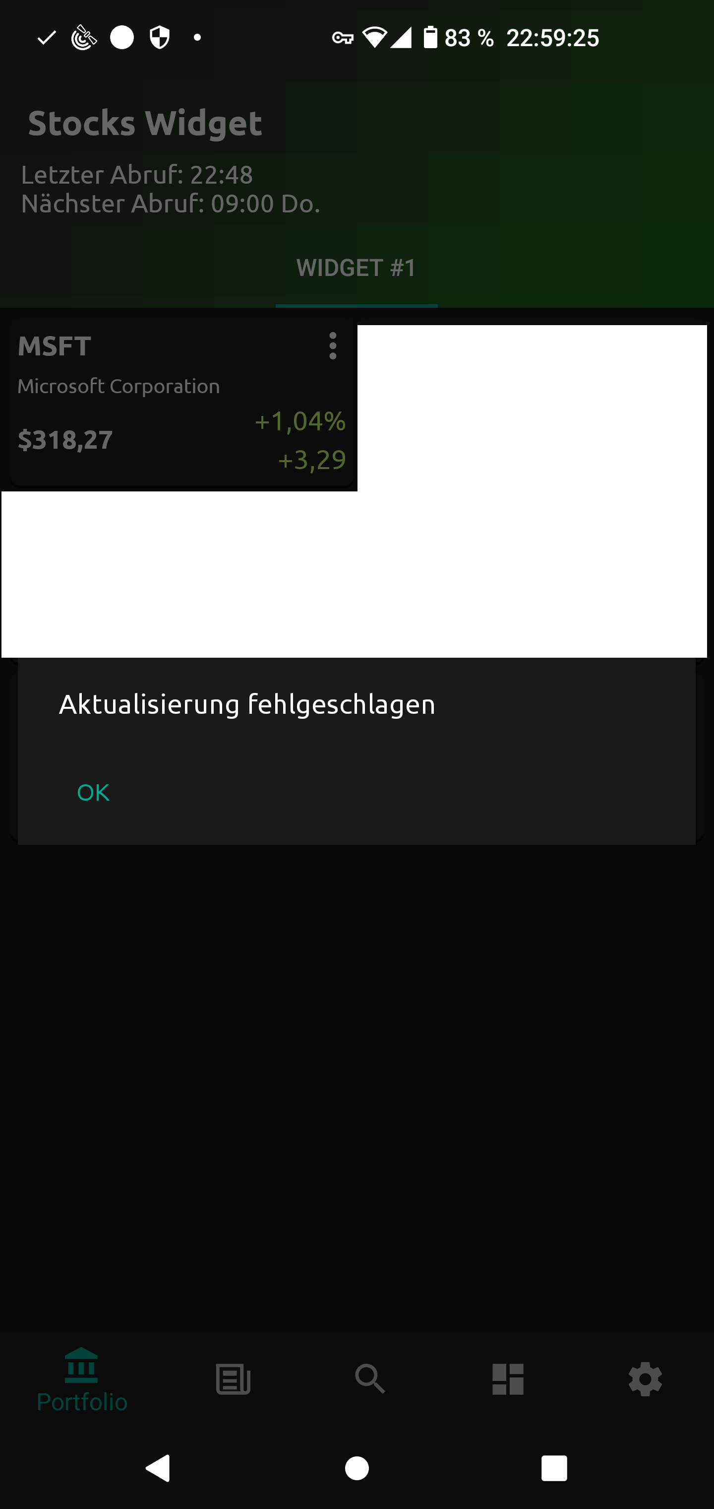

I’m still struggling with some connectivity issues, but have never been able to really put a finger on them, yet.
The weird thing: Those issues only occur while I’m in my wifi. When connected through 4G, etc. it works.
Now you’d think “ok, then it must be my home firewall.” But my other phone with a stock ROM and some of the same apps don’t have those problems. And when switching off iode filtering, it also worked at home via wifi.
Let’s focus on the stocks problem. Since the yahoo address must be on some generic blacklist, I had whitelisted the address for that stocks app. Connection failed as indicated (in German) in the upper right corner of the first two screenshots:
Here’s the “log” from iode which says it was supposedly allowed (but the app couldn’t download):
Now I unauthorized it again for that single app in order to generally authorize it for all apps:
Don’t have the success screenshot at hand right now. But it worked only if allowed for all apps.
I haven’t written a widget app myself, yet. Maybe the connection attempts leave with some different source package name. Just a theory.
But I was able to reproduce this: When authorizing the Yahoo address for the stocks app only, it wouldn’t work. I had to generally allow it. That’s not how it’s supposed to work, isn’t it?

I cannot reproduce. I tried the Stocks app on three different phones. It worked on all, by authorizing the yahoo domain for the app only…
that’s what i mean. @oRKywork say, it only happens in his wlan. but not outside or in mobile data.
so, for me it smells like DNS blocking…
Yes, but I don’t understand why whitelisting works for all apps works, and not for the Stocks app only ? Both should be blocked if there is an external blocker…
No, not if the domain is only blocked by a blocking dns (e.g. Quad9, cleanbbrowsing, etc…) on a external router which act as DHCP server or standalone nameserver in the home network. and NOT by the phone for itself (iode app)
Ok, but the external router should block the yahoo domain also when it is whitelisted for all apps ?..
Or: on the phone itself, there’s an app which ensures all DNS requests !! So the domain should be unblocked for that app too. But it should appear in the live stream…
That’s while I asked above
The key symbol
Normally it stands for a vpn?
The iode app does not bring this symbol. Or?
But all other AntiTracker or Firewall Apps with DNS filter…
Yes it’s a VPN connexion, and no iodé does not use it. That’s an advantage of our approach wrt some other blockers which entirely run in user space but require the VPN.
So probably, the app that uses the VPN also captures the DNS traffic, but is itself filtered by iodé. Probably, unblocking the yahoo domain for the Stocks app and the app that manages the VPN would work.

The additional filter VPN (Netguard) was not the issue, but I should have disabled it before reporting here nevertheless.
It looks like I may have misunderstood something about the configuration of the 3 different categories
Standard | Enhanced | Adapted (I assume those are the English translations).
Unfortunately I hadn’t taken a screenshot of it to see what its setting was yesterday. I see now that in order for “allow for app xyz” to work, it requires the “adapted” checkbox to be active for that app as well.
I apologize for the trouble I’ve caused.
Currently it’s working. However it doesn’t explain why it worked when I was out of my wifi.
As I said a couple of other phones without iode had no issues to make those connections.
