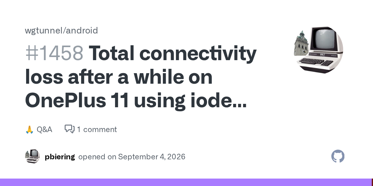

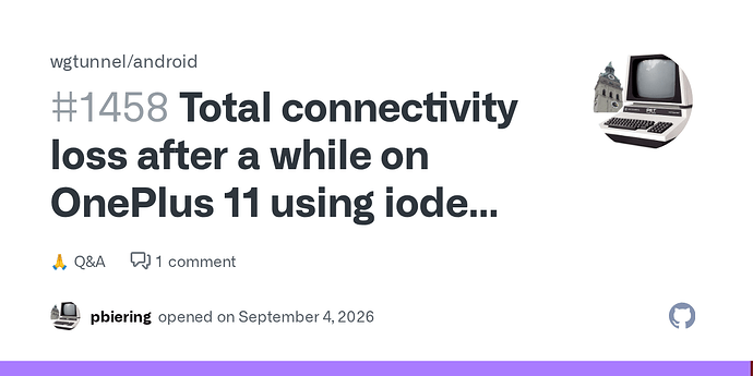

Wgtunnel / autotunnel sometimes result in total connectivity loss
Reported originally in “wgtunnel” discussions, but they haven’t seen such behavior so far in general and assume it’s an issue in combination with using “iodeOS”.
