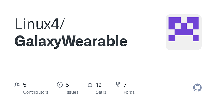

Solution: There are patched versions of the apps that skip this device check.
Linux4 (the lineage maintainer for many Samsung devices) offers the wearable app and some plugins for download:
If the right plugin for you is not included, you can also patch it yourself with the following instructions:
It’s not easy, but it worked great for me. I have the Galaxy Buds 2Pro and I couldn’t find a patched app for it

I would definitely add this link here to your links in order to download all needed files to start:
With that i got my Galaxy Watch 3 working.
