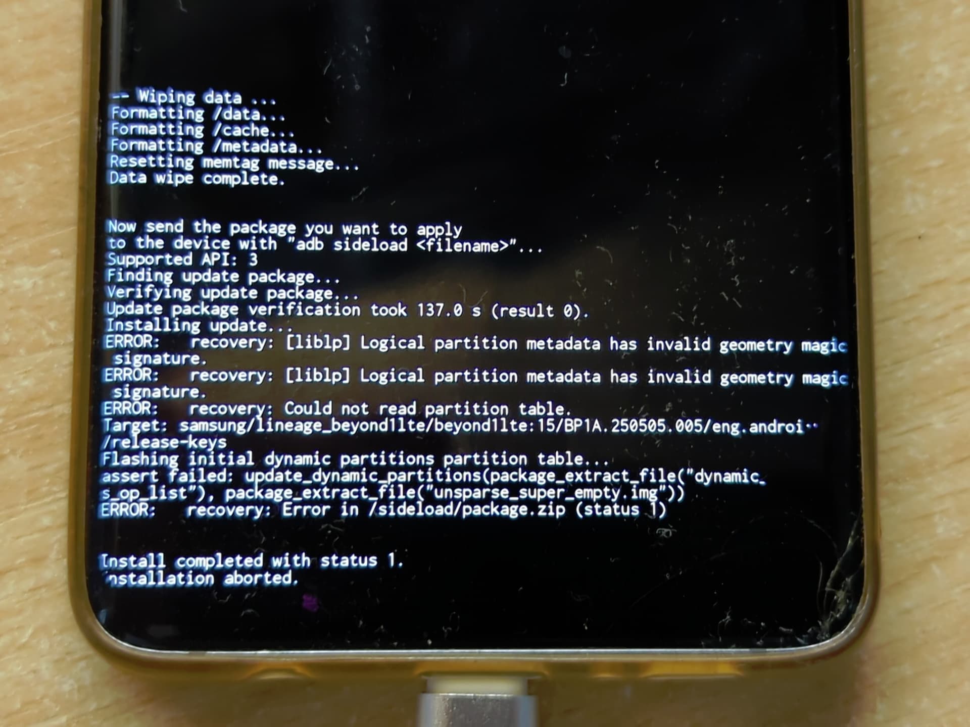

I used the same cable as before, but there were no driver issues any more. So I used the instruction from iodeOS gitlab (link in first post). But at the first try installing iodeOS 6.5 I again got the error “failed: update_dynamic_partitions”. I also got an error regarding dynamic partitions using TWRP.

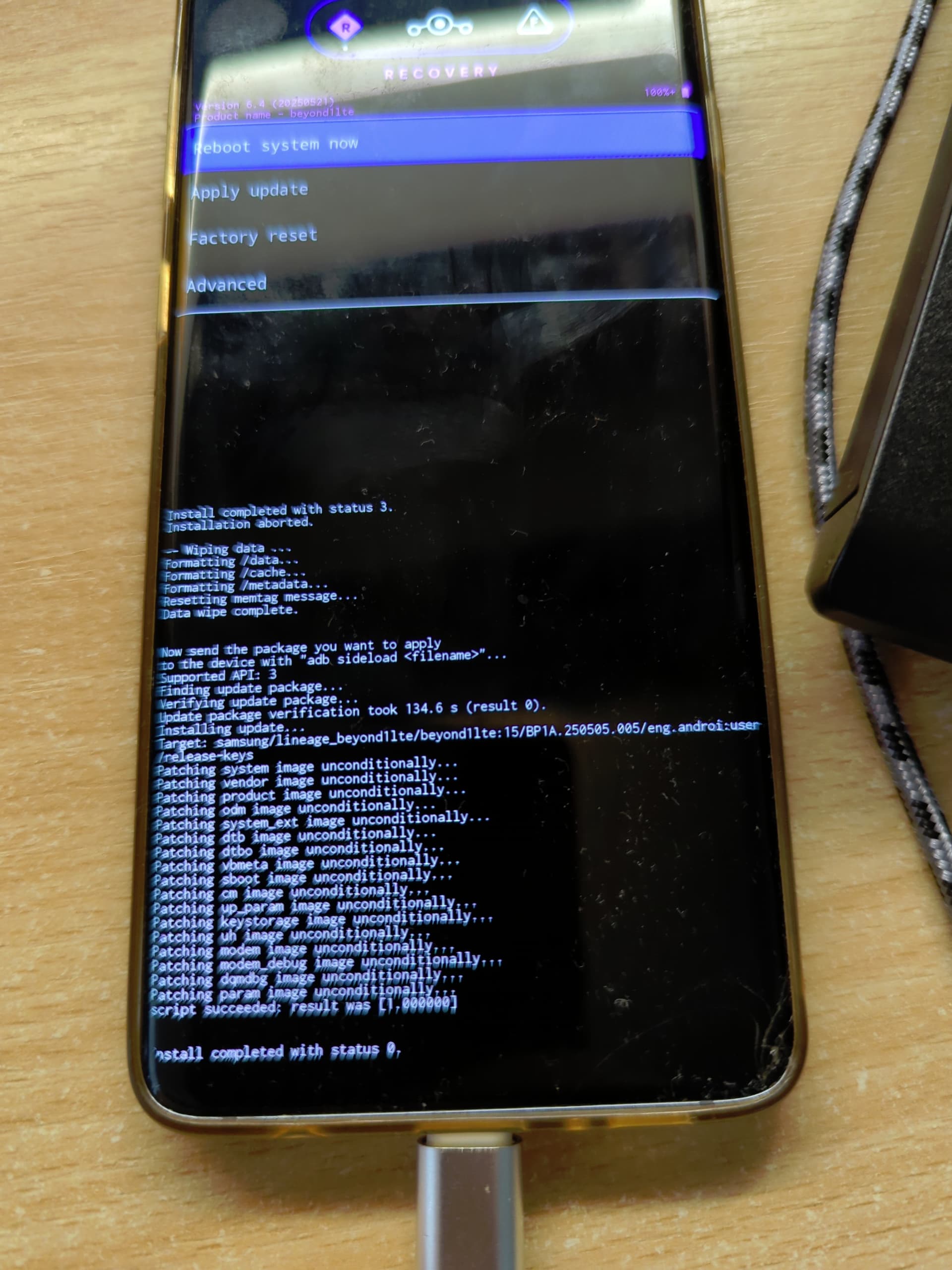

After this I read only that I have to flash stock rom in this case and then I can install custom rom. But I was to lazy to do this. So I simply installed the iodeOS recovery 6.4 and tried installing iodeOS 6.4. And there I could install iodeOS.
I don´t know why 6.5 wasn´t working and 6.4 worked. I dont´t think it is a question of the version, but just the point that I tried it several times and between there were some reboots… But now I have back a working phone!!
