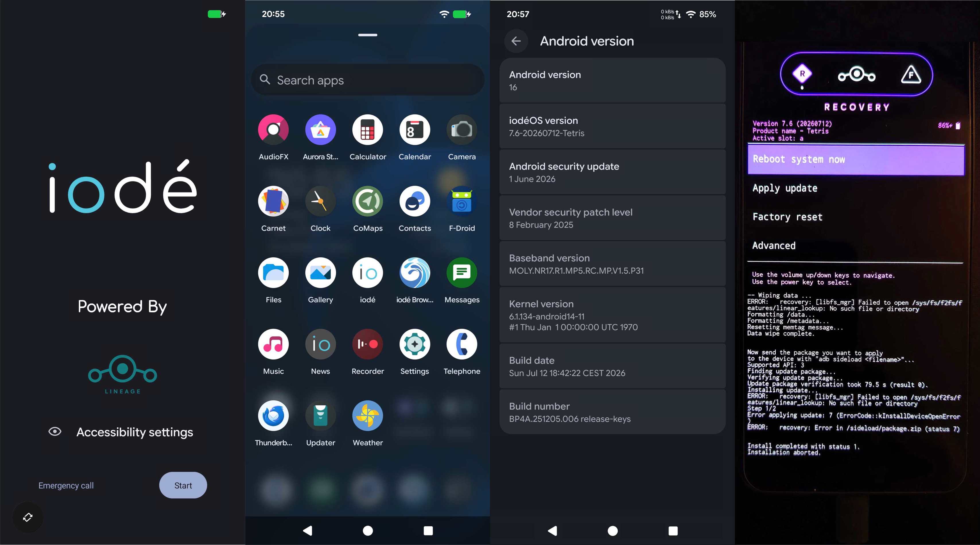

My classic installation via iodéOS 7.6 recovery failed
Install completed with status 1.
Installation aborted.
@ronnz98 I’ve run into this error quite a few times, whether with /e/OS or iodèOS ROMs. Could my suspicion be correct that a local update or OTA update will also fail?
Ultimately, I manually flashed all 35 files from payload.bin, within the ROM.zip, to slot “A” using “fastboot flash”.
