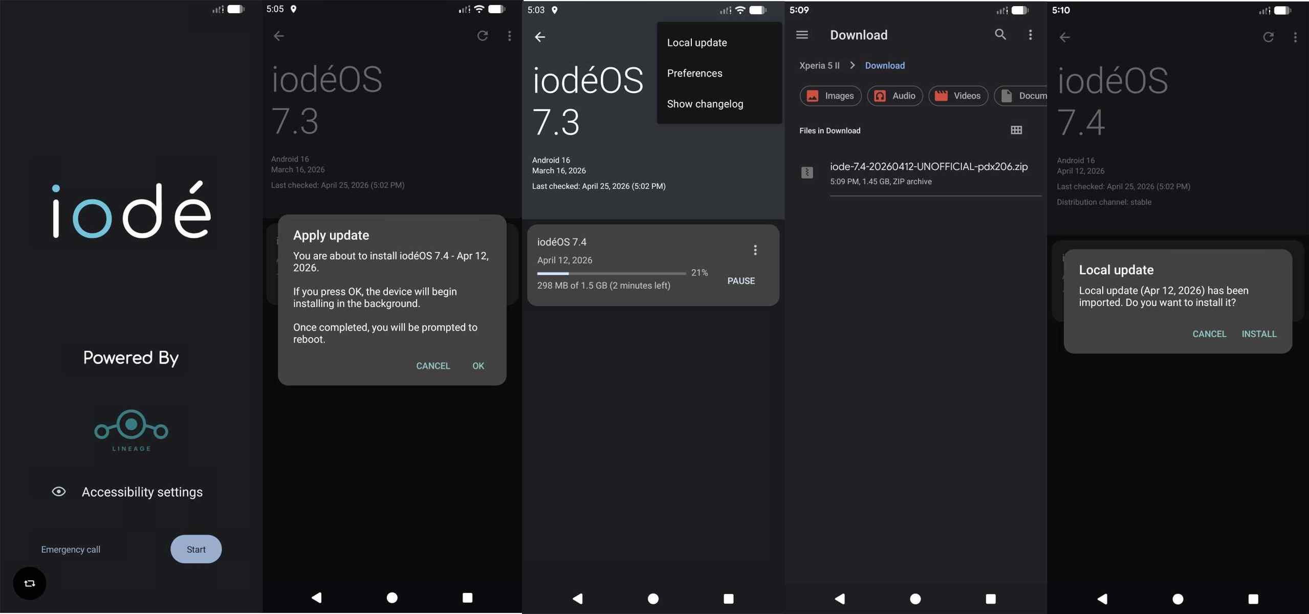

YAAP A16 was installed on my pdx206, and the bootloader was locked again before I installed iodéOS for testing purposes.
I unlocked the YAAP pdx206 bootloader as usual using fastboot oem unlock 0x[unlock-code]. After that, I installed iodéOS 7.3, followed by an 7.4 OTA update and a 7.4 Local update.
XAAP A16 20260402 is now installed again and the bootloader is once again locked using avb_custom_key.img by dev @ahnet

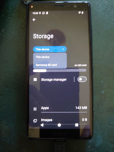

I’ve just flashed a couple of XZ2c’s with v6.15 and neither of them recognised the 32Gb SD card I had inserted. To test the card I put it into an XA3 I flashed yesterday with Kirin and it appeared in the ‘This Device’ dropdown box in settings>storage immediately. Anyone else got the SD bug?
I can’t reproduce this bug. I dirty flashed iode-6.15-20260516-UNOFFICIAL-xz2c.zip over an installation of los4microG 22.2. The SD card was recognised, and the files on it were readable and writeable.
Were you clean flashing? If so, maybe try flashing lineage-22.2-20260429-microG-xz2c.zip (from here), see if the card is recognised, then flash the iodé zip file over that.
Another question? How were you flashing? (Presumably adb sideload). Which recovery did yiu use?
Also, have you at some point followed this step of the LineageOS installation instructions?
If not, then maybe worth a try.
Apart from that, no more ideas!
Was using adb sideload. I was also using iode 6.15 boot.img. I did use the Lineage OS method first flashing boot.img, then copy partitions, then wipe/format, then flash the iode zip. Exactly the same method was used on both XZ2c’s. I will give the dirty flash method you posted a spin and let you know if it works. Might have to be tomorrow now as I think my partner has her own ideas about the game as far as tonight is concerned. :worried:
Back at the desk this morning @petefoth and attempted the dirty flash but it’s telling me LOS 22.2 is an SPL downgrade. Can you tell me exactly which version of LOS iode 6.15 was based upon? I don’t want to risk upgrading beyond 6.15 and solving one problem by creating another.
Sadly not. LineageOS is a rolling release. The iode 6.15 build for xz2c was started at 21:32 UTC on Saturday 16th May and will include whatever code was in the LineageOS repos when the repo sync was done immediately before that. The previous build finished at 21:04 so the call to repo sync will have happened shortly after that.
I’m not sure why that is an SPL downgrade, but you could try clean flash of lineage-22.2-20260429-microG-xz2c.zip, then dirty flash the iodé build over that.
Morning Pete…. tried the clean flash of LOS 22.2 but same SPL result so decided to go to EMMA for a stock reinstall and then a straight iode install only adding the LOS copy partitions and format before flashing the iode.zip and………..
Very strange! …..but also very pleasing, cos I can get them listed .
