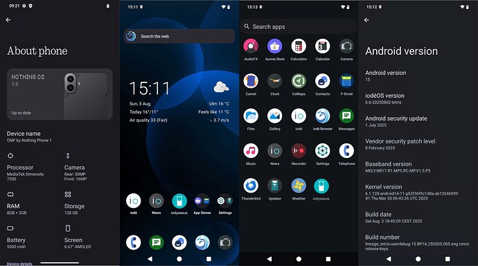

All right, but your iode-6.6-20250802-tetris.zip file does not contain a file called super_empty.img
Other tetris custumROMs such as RisingOS_Revived-6.3-250415-1235-GAPPS-COMMUNITY-tetris-ota-signed or lineage-22.1-20250406-UNOFFICIAL-tetris or Project_Infinity-X-3.0-tetris -20250802 contain the file super_empty.img
CMF by Nothing Phone 1 A015 tetris
Well, that the file structure of iode-6.6-20250802-tetris by @ronnz98 is identical to the stock Android 15 Tetris_V3. 2-250609-2111_3.2, I successfully installed iodéOS 6.6 classic in both slots (A/B), after deleting the temporary COW partitions that take up a lot of unnecessary space in the superpartition.
Actually I used this source:
https://xdaforums.com/t/rom-15-tetris-droidx-ui-official-stable-aosp.4749787/
DroidX also uses a file called super_empty.img but iodéOS 6.6 does not really need it, as it appears to me at the moment.
