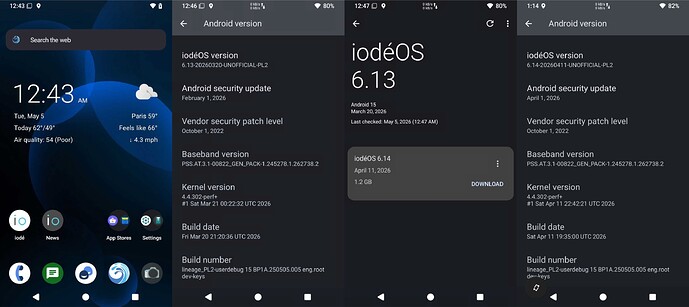

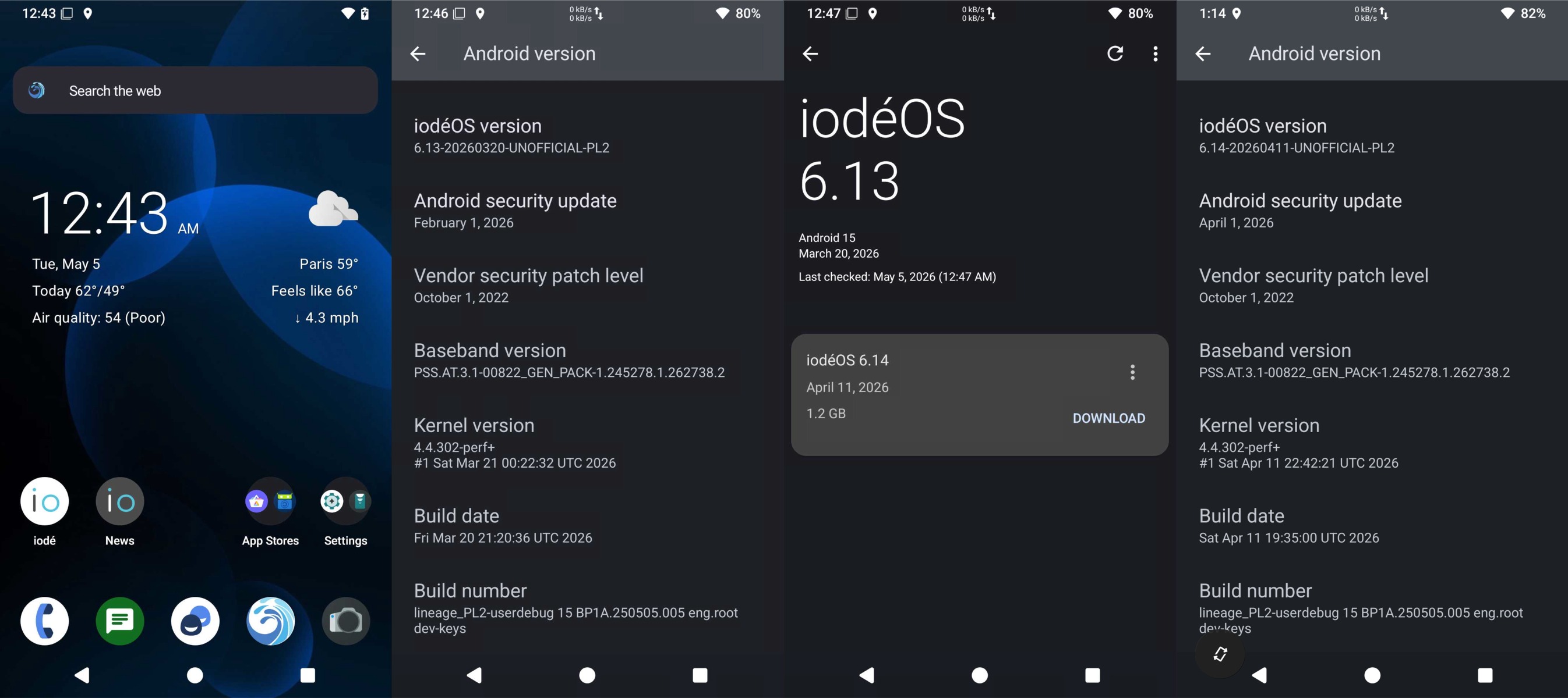

from LOS4microG to iodéOS via clean install per iodé-recovery, then adb -d sideload iode-6.13-20260320-UNOFFICIAL-PL2.zip and then easily updated to iode-6.14-20260411-UNOFFICIAL-PL2 via OTA-Update.
The entire flash process and OTA update take a little longer because the SoC Qualcomm SDM630 Snapdragon 630 is not very powerful. Otherwise, the Nokia 6.1 is a solid companion with a stylish all metal design, embedded in a color-accented aluminum frame and aluminum back cover.

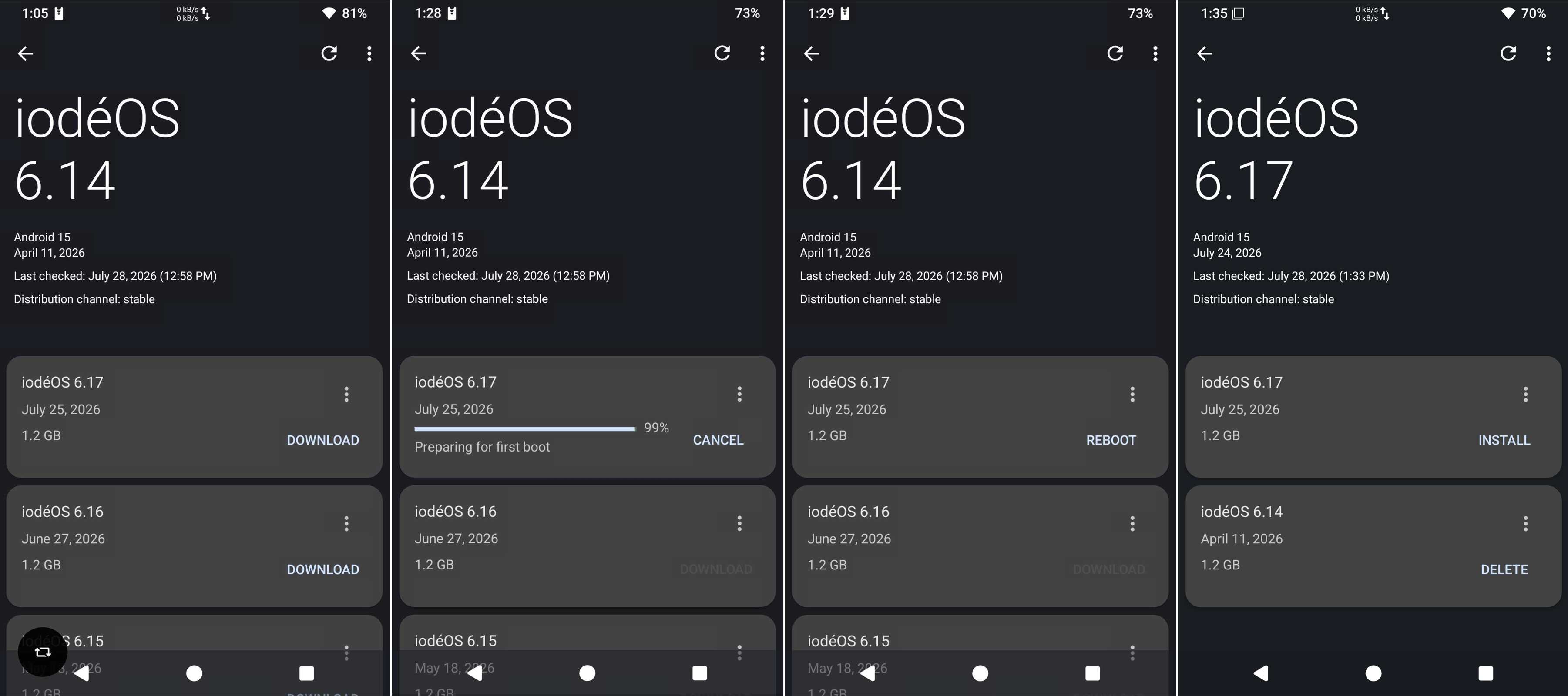

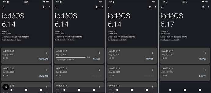

:new_button: OTA :up_button:DATE (A15) iodéOS 6.17 20260724
Preparing for first boot and restart feels like it’s taking forever, but it works. Good things take time. Thank you DEV for the regular updates.
