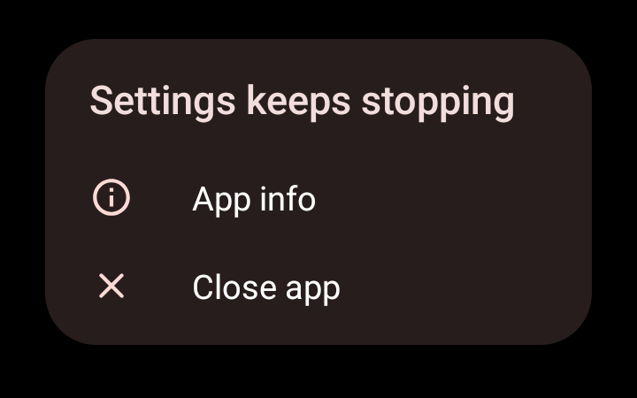

Thanks for the testing and the followup, I haven’t been motivated enough to get TTS working as I don’t have a use case for it currently, but I would like to narrow down why I had problems setting up SherpaTTS (with matching errors that you reported, the app kept closing, etc), as that seems like the obvious choice. I’ll probably get back to re-testing it in the somewhat near future too :slight_smile:
