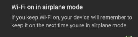

Your question is not exactly yes or no. If you turn on Airplane mode, it will turn off the Wifi and Bluetooth, unless you turn them back on. In which case Android (possibly Lineage or AOSP) will ask you if you want to have the Wifi turn on every time you turn on Airplane mode. So if you confirm that’s the behavior you want when it asks, Wifi will stay on and Airplane mode will only affect your phones cellular connectivity.
So yes, Wifi is on, but I am not manually turning Wifi on. At least not since the first time it asked me.
Edit: I actually found a screenshot of the feature. I will share it here so people can see it:
