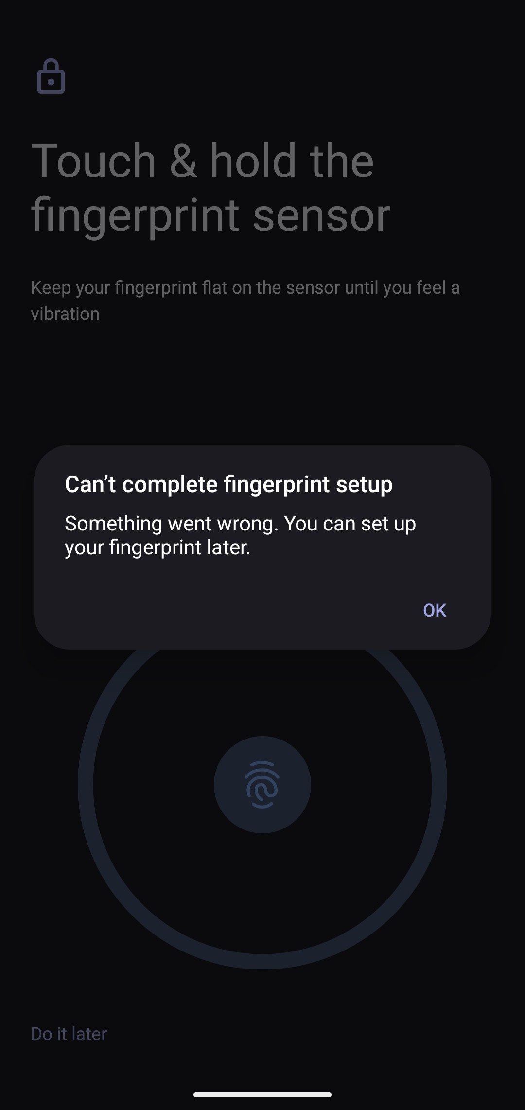

I’m running the latest iodeOS official for my device Google Pixel 9 (Tokay), and I’m having trouble to setting up the fingerprint sensor.
The system doesn’t allow me to enroll my fingerprint, the setup fails immediately after clicking start
Info that may help:
ROM: iodeOS 6.8
Bootloader status: unlocked
Kernel: non-stock
PIN/Pattern: working
Additional info:
*Fingerprint works fine on other ROMs Like Project Infinity X
*I don’t use a screen protector
*I didn’t use iodeOS Previously, iodeOS 6.8 is the first release that I used
What I did so far to fix it:
*Rebooting
*Re-setup PIN Number
*Reinstalling iodeOS to the other slot without losing data “adb sideload ota-update.zip”
If you guys need any other info, please mentioned it
