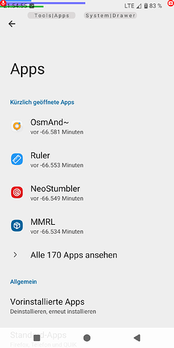

I installed iodeOS 6.5 on a Shiftphone 6mq and meanwhile updated to 6.6. Some time after the update I noticed that the list of recently used apps on the first screen of the Apps system settings is not refreshed. The listed 4 apps always remain the same. But the issue may have happened also before the update.
Notice the number of passed minutes (negative)!
How can I fix this?

This time the issue was solved after I tested a few new apps. I installed some and removed all of them except one. Afterwards I saw that the list was refreshing again.
