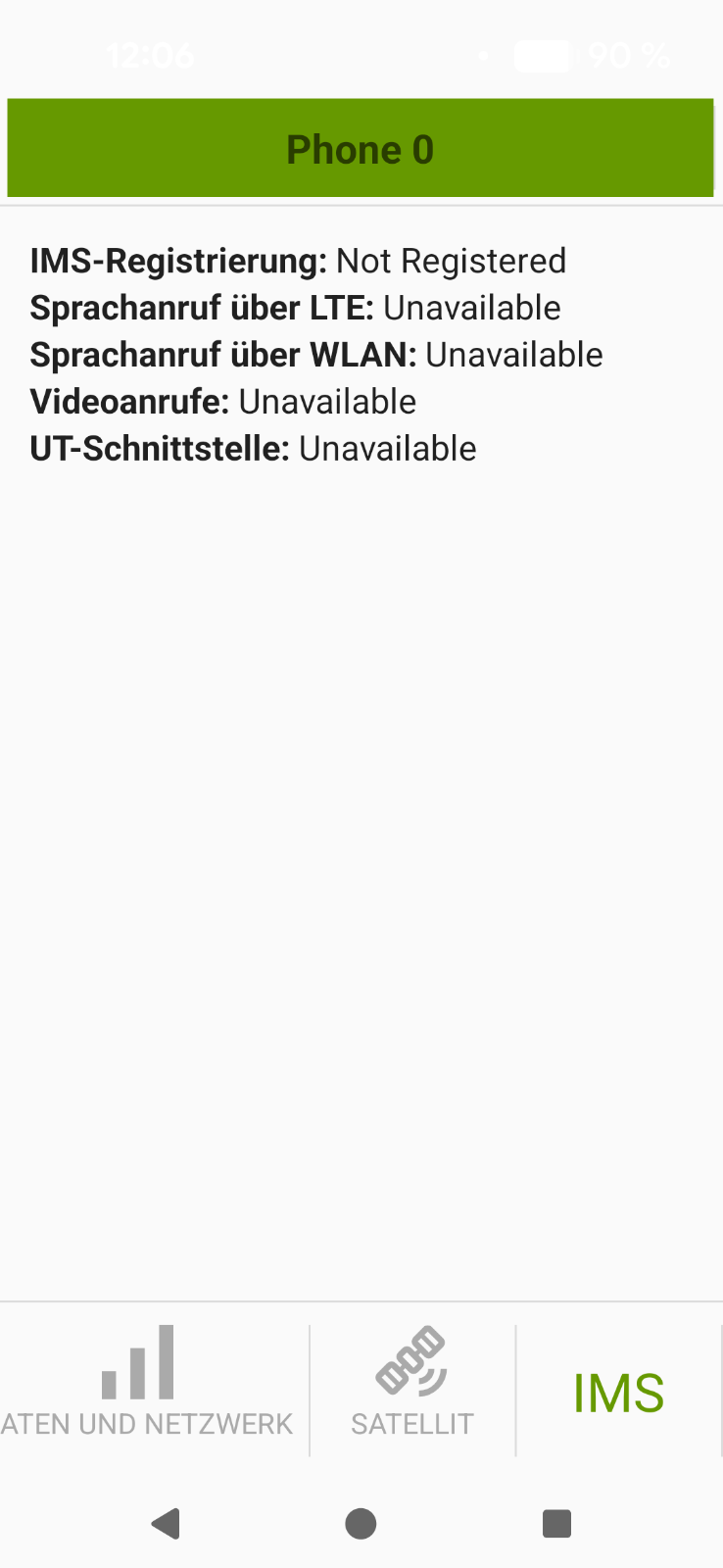

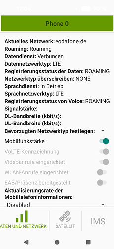

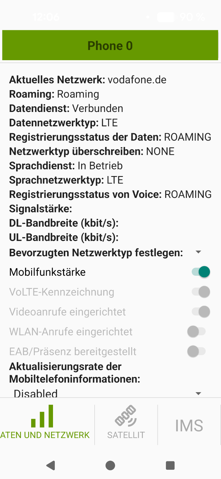

I attached 2 screenshots from my phone, first one looks good ( I am traveling and therefor the roaming), the IMS not so I guess. But can I do about that?
IMS registration requires mobile data / APN settings being correct, so I still suspect them. Can you get that info? (look at the link above for "non-working mobile data / voice calling guide)

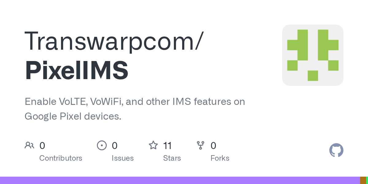

I found this stuff and thought I might give it a try, but I am not a really competent user fully understanding much (or even all!?) of this and so I am hesitant.
What do you guys think:
https://www.androidauthority.com/pixel-ims-update-fix-3606811/

Since your carrier doesn’t allow the Pixel 4a to use VoLTE / IMS registration I don’t know what this would solve: the problem isn’t that the hardware doesn’t support VoLTE, it is that your carrier is not allowing it… right?
I am also confused a bit by the purpose of the PixelIMS project: all the features they note are already supported for the devices that the project supports?
