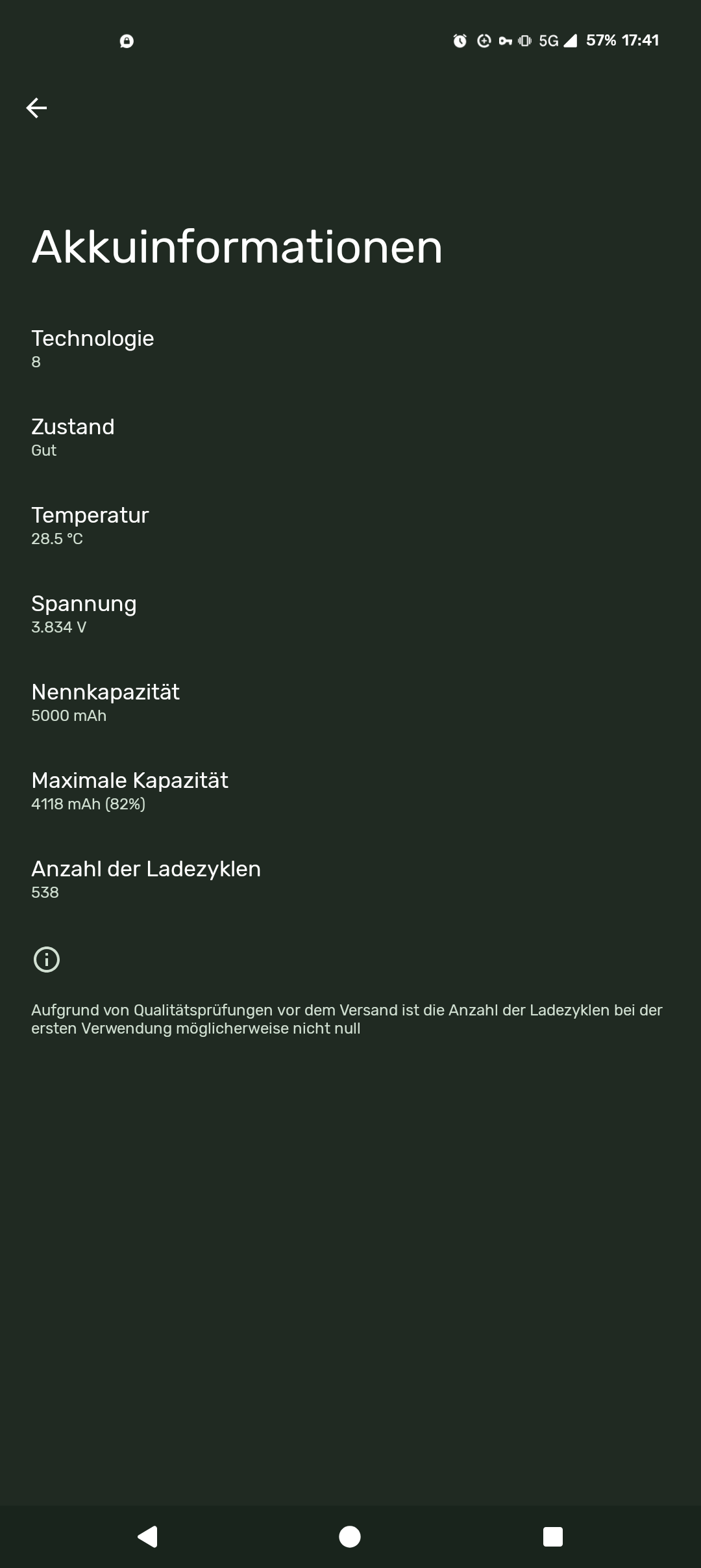

Also, just curious if you could report your battery capacity when you look at “System Settings > Battery > Battery Information”. Report the Design capacity and the Maximum capacity (with % rating even though it should just be simple math).

I don’ trust this values, the OnePlus 11 is a really new one, (ca. one year).
Could it be a trouble with stats?
