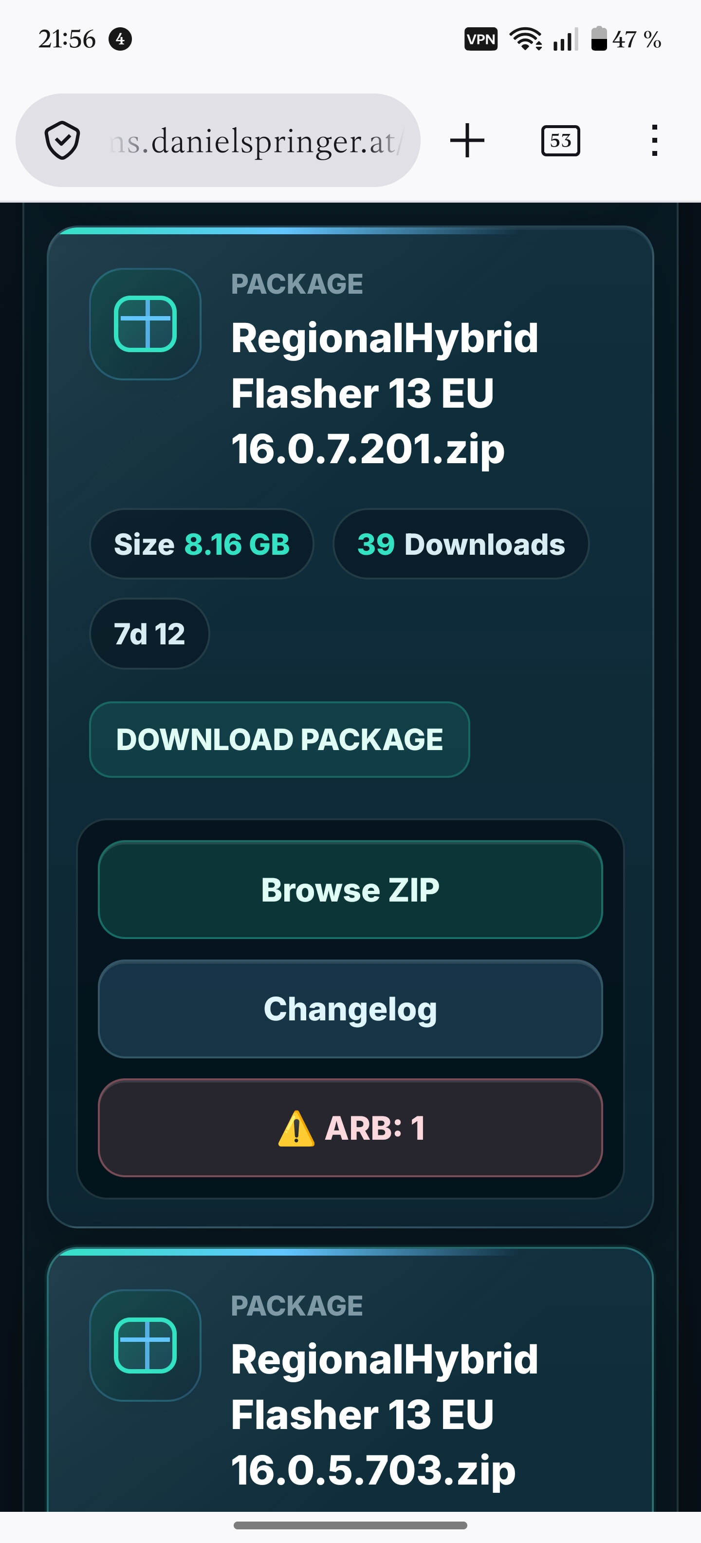

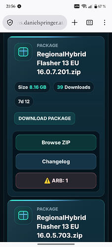

Oneplus 13 mit ARB = 1

Unfortunately, this version also has ARB = 1
Yes, it is ARB=1, but that means you are not rolling back when you install iodéOS, and thus won’t “blow the fuse.”
