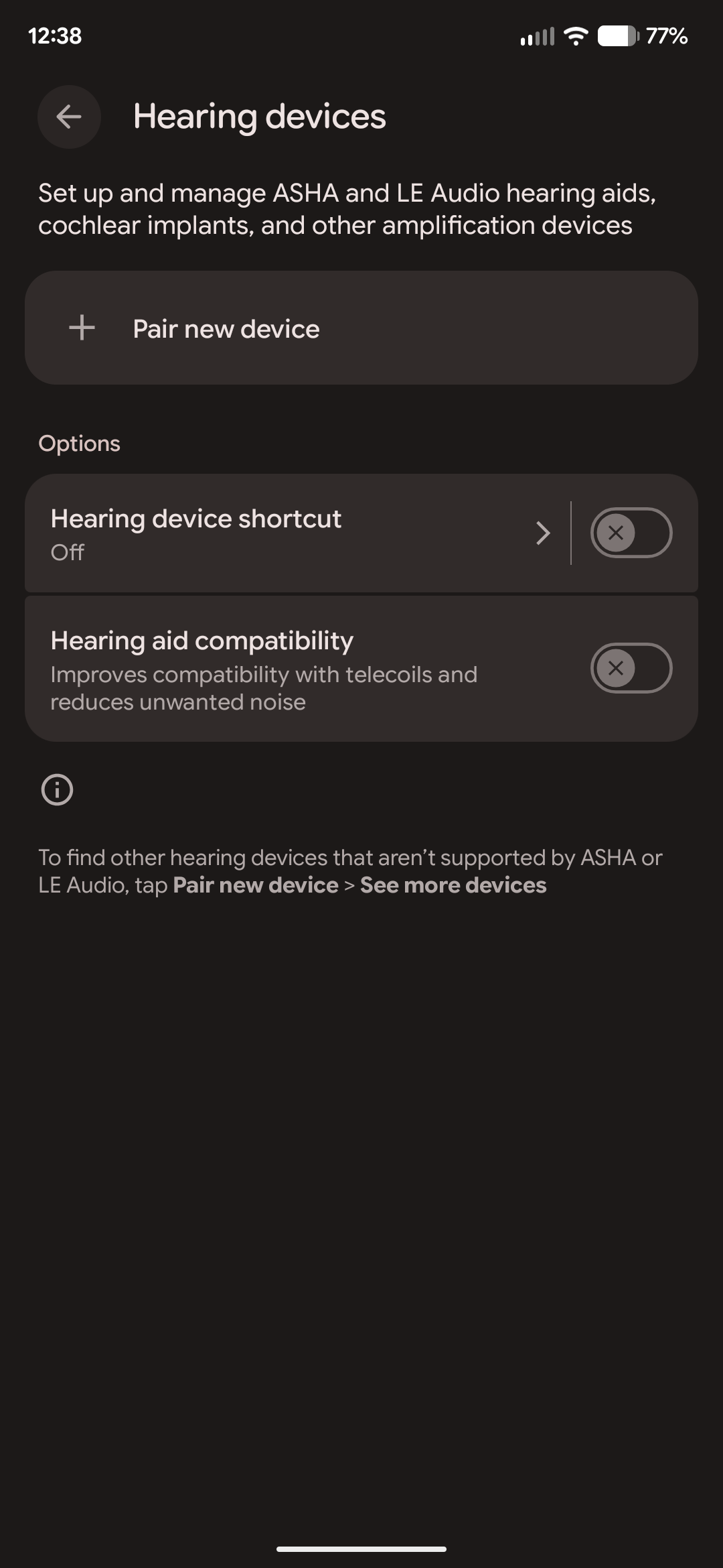

@lindsayb37 or @Erzaui “System Settings > Accessibility > Hearing Devices”: Enable “Hearing aid compatibility” and also does “Pair new device” there for “AHSA or LE Audio” devices give you something with your device ready to pair?

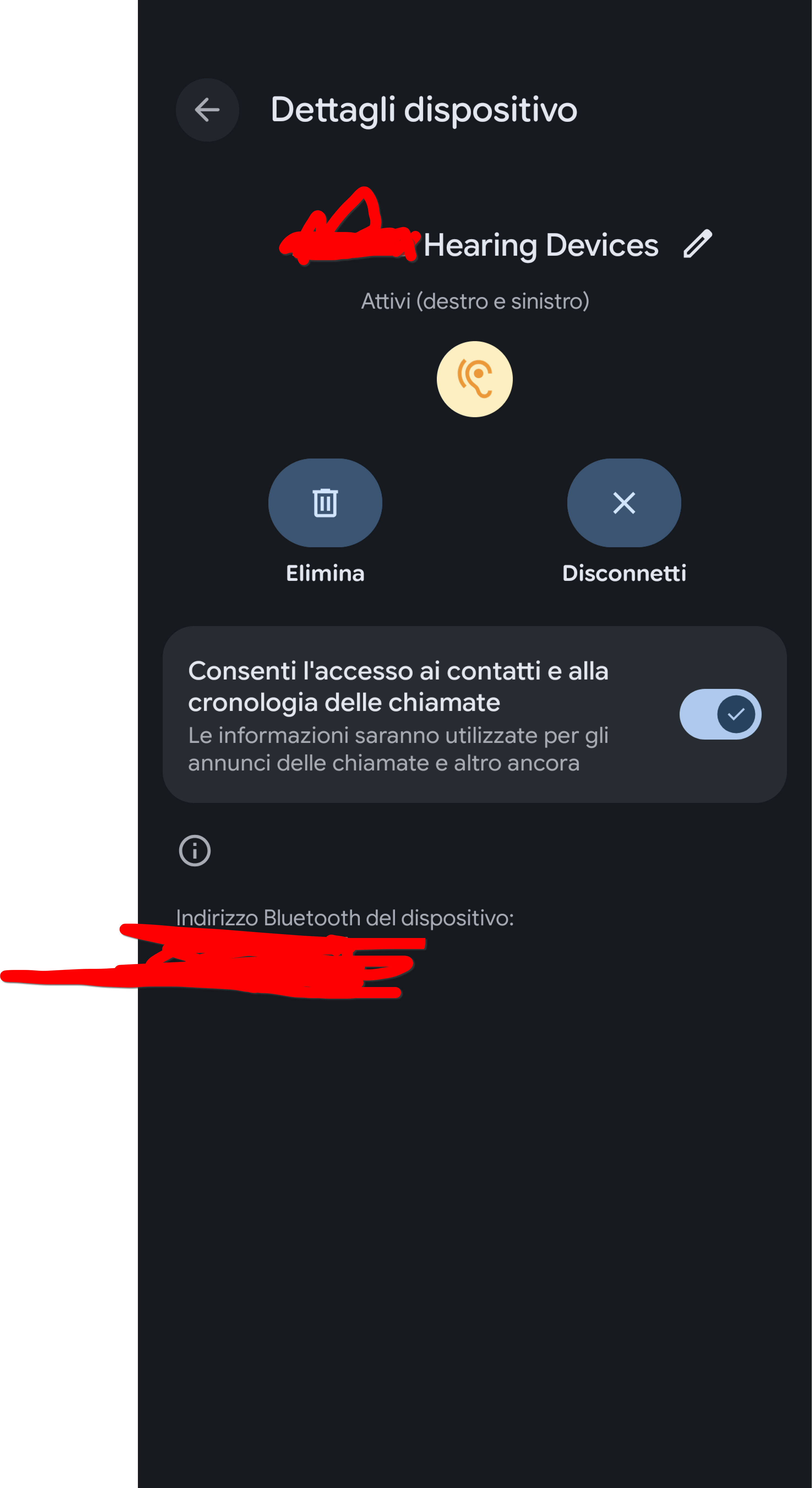

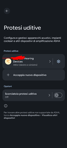

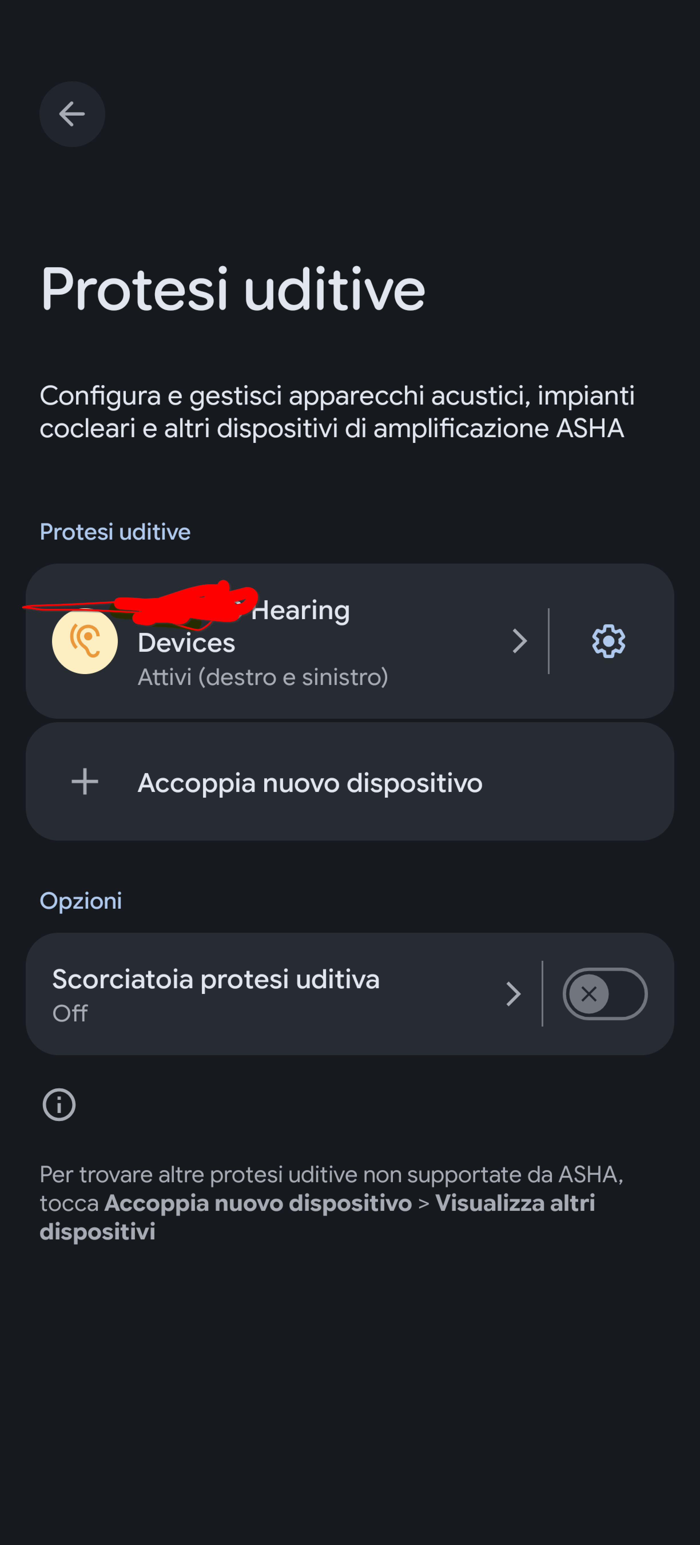

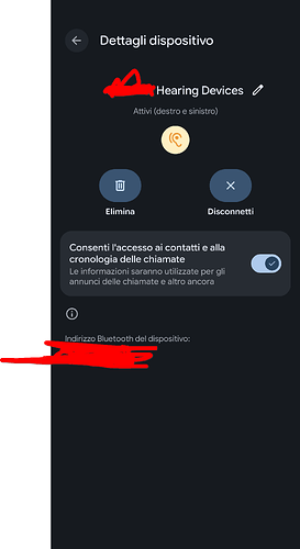

This is that i can see, i don’t see enable hearing aid compatibility. In the calls i can’t hear the other people that talk me, behind request i sent logs of problem to calyx repo, before that i uninstall iode do you want logs?

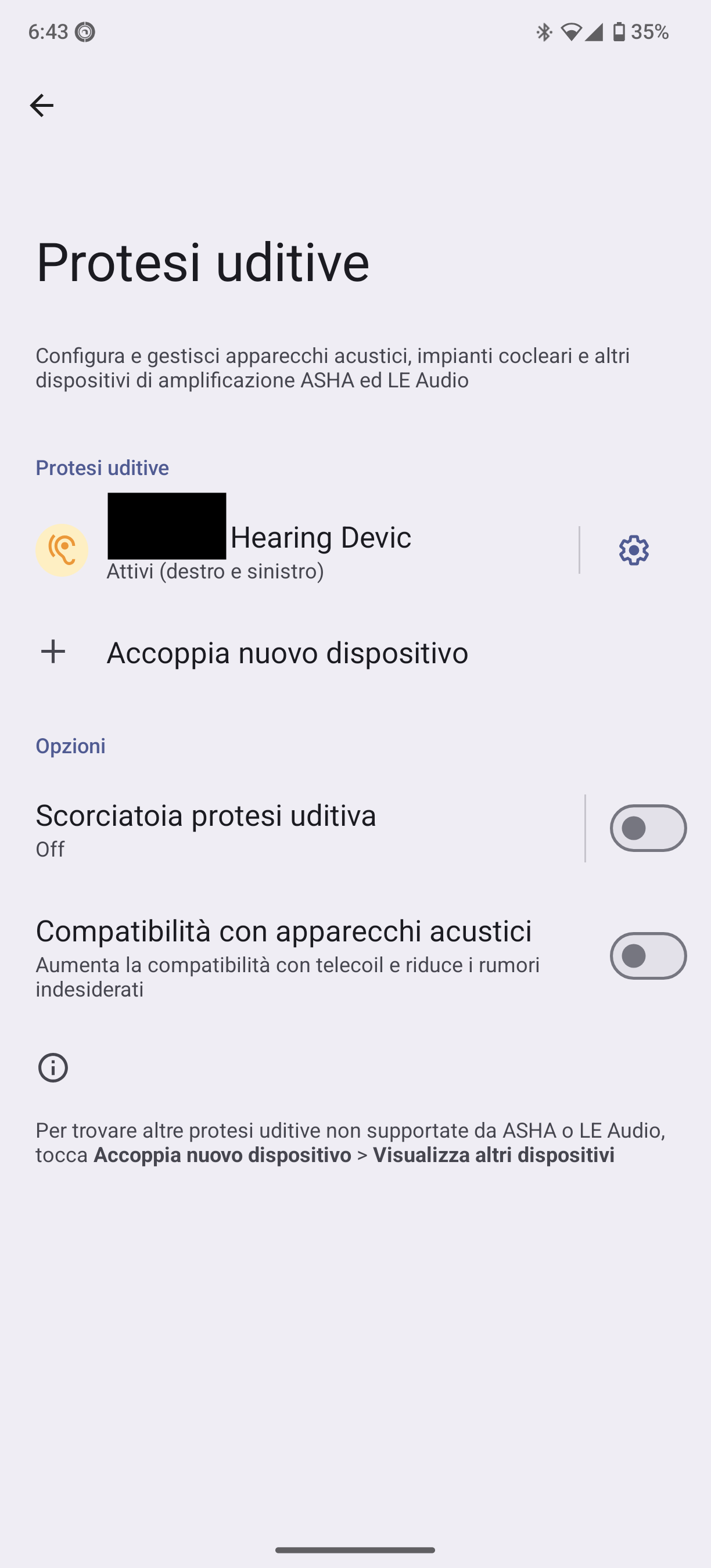

It is interesting your title is only about ASHA devices. On my Pixel devices it shows “ASHA and LE Audio hearing aids”. So there is something additional with Pixel firmware blobs (?) that also enables “LE audio hearing aids”?? This is what also then gives the additional option below of “Hearing aid compatibility” I think, as the non-Pixel I am testing doesn’t have that either (OnePlus 9 Pro).
