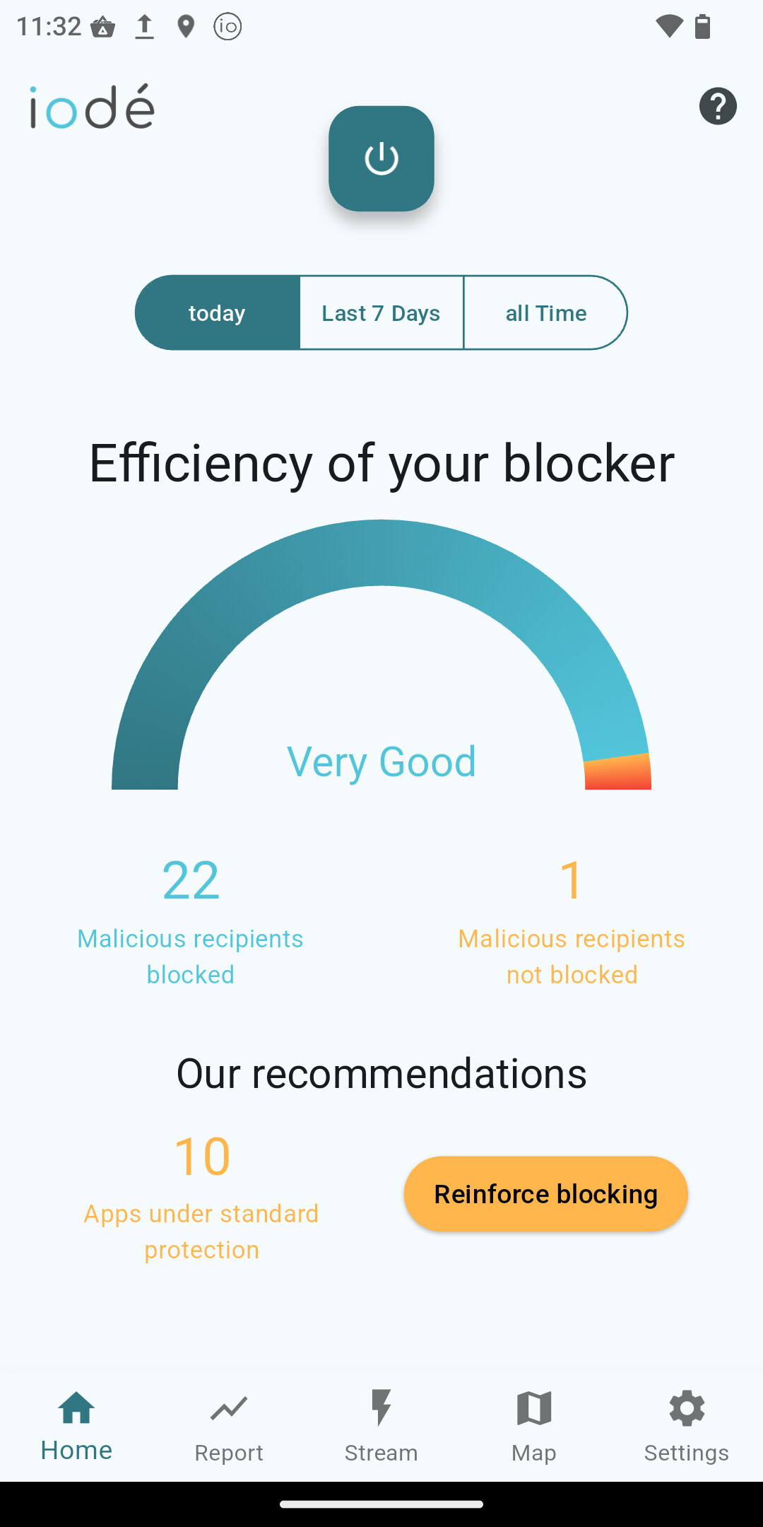

Can you try another browser? Have you looked at the iodé app stream to see what may be getting blocked?
I haven’t tried a different browser. But, what is “iode app stream”? I just put that as a search phrase and nothing comes up.
This is iodé 's “USP” (unique selling point). Under the “stream” tab at the bottom you will see all the device network activity.
This stream thing is interesting. With the Iode Browser, it shows me requesting wikipedia.org, but doesn’t let me query beyond that because I’m required to have a premium account. I installed the DuckDuckGo browser, and it only shows requests to duckduckgo.com, not to wikipedia.org as I requested. Next, I installed the actual Firefox, and it shows me requesting wikipedia.org.
In Iode app, turning off blocking does not change browser behavior - still cannot get to anything.
I also checked and made sure the browsers all have mobile data access permissions and the like.
