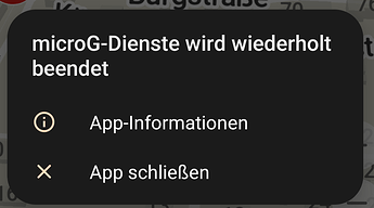

MicroG services crashes every few minutes, when on the road with navigation, whether it’s a logbook. MagicEarth or CoMaps.
Android 13, iodé 4.28, S10e.
