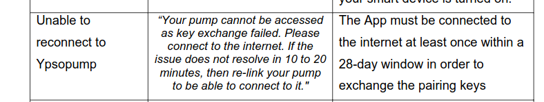

In pump manual, this message is documented.

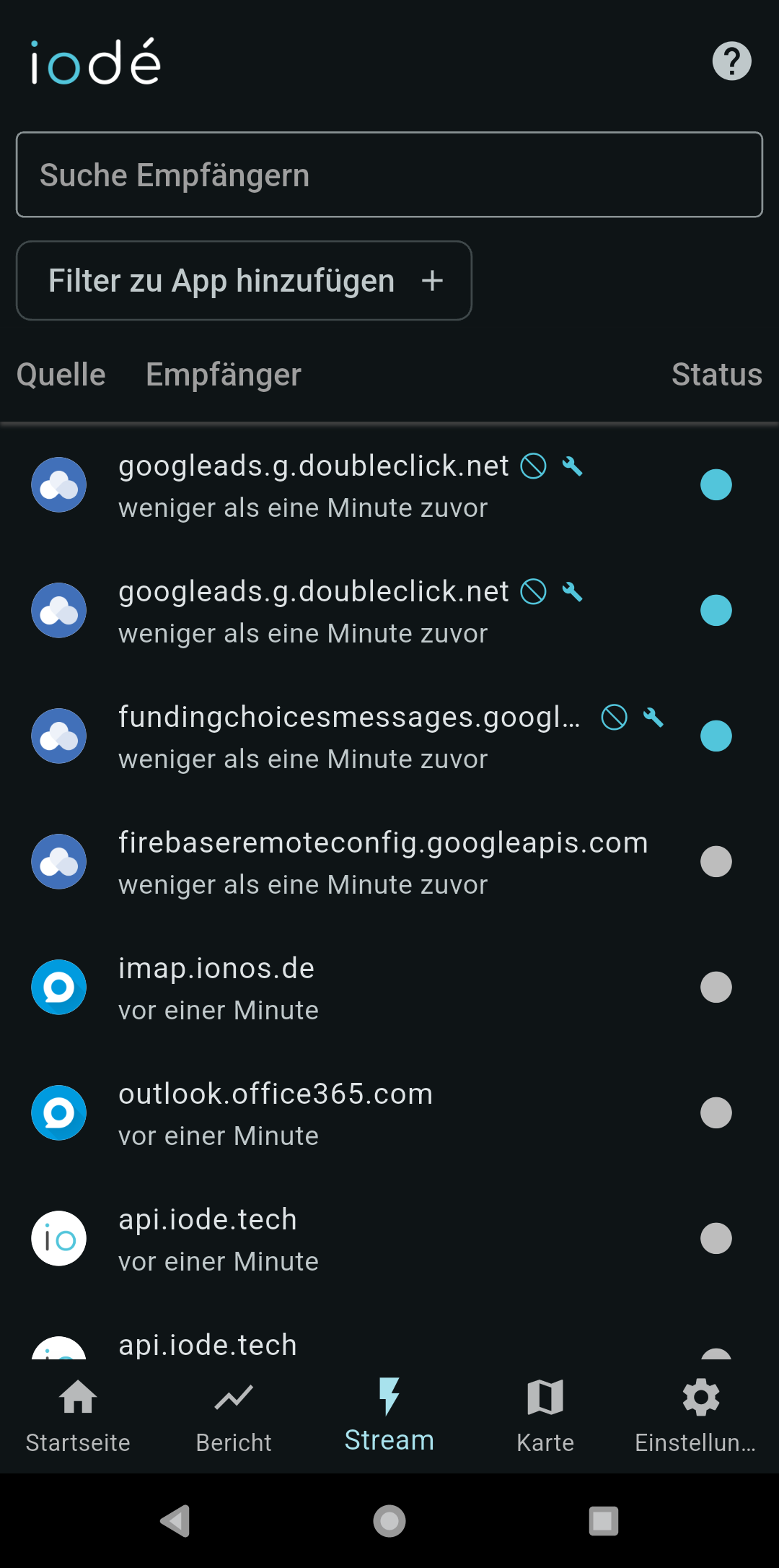

Is there any possibility that iodeOS still filter some internet access?
Trebuchet is your launcher (Homescreen + status bar + …). Your blocker is the iodé-Blocker, in settings and Trebuchet shown as „iodé“.
Btw.: You shouldn’t force-close the launcher, as this could cause the phone to reboot if things go wrong.
Check the iode blocker, if something is blocked. Blue is blocked.
