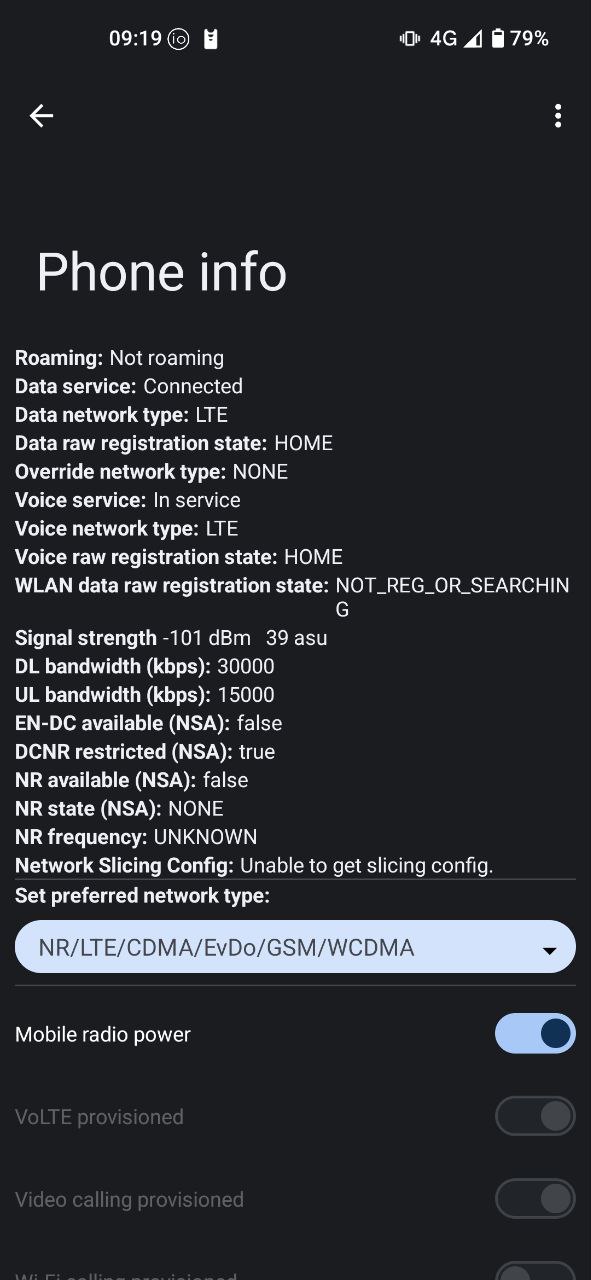

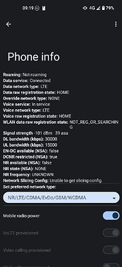

I am using it since a couple of days. And also have no 5G.
I think, that 5G support also depends on your network operator. In my country, at the begining of Pixel 5 life cycle the phone has not been supported by our operators 5G networks. After aprox one year, suddenly 5G on Pixel 5 started to function - the operators switched its support on after agreement with Google. So it depends from which exact Pixel device your network operator made agreement with Google.
Yes agreed, @Lazy you may need to check with your carrier to confirm it isn’t being blocked.
You and @gc35sdd are right. My carrier doesn’t support 5G on the Pixel 5.
Well, doesn’t matter. I mostly use the phone for messaging. No real need for 5G.

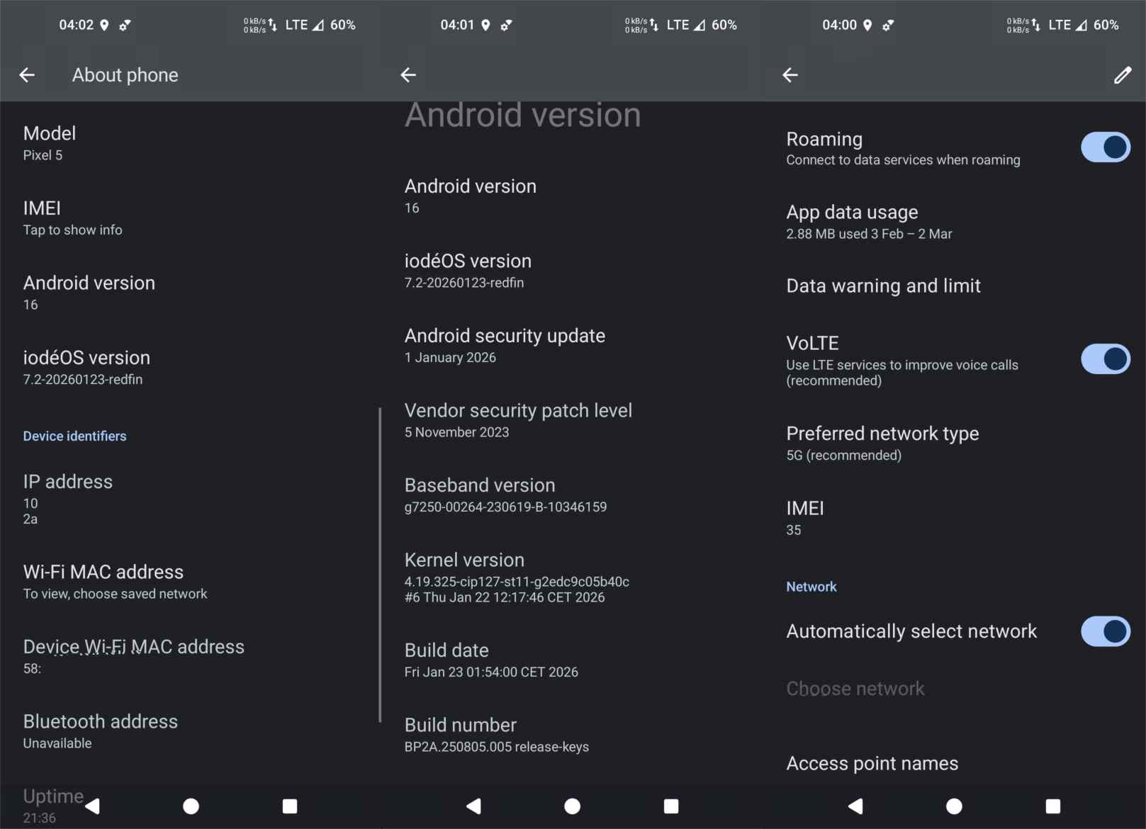

My SIM provider also does not support 5G on the Pixel 5 (redfin), although the redfin displays 5G (recommended).
Likewise, the latest version of Google Android 14.0.0 (UP1A.231105.001.B2, Feb 2024) supports no 5G, no VoLTE and no Wi-Fi calling - although Pixel 5 redfin displays 5G (recommended).
Not every CustomROM for the Pixel 5 supports VoLTE and Relocking Bootloader – but iodéOS 7.2 does this!
