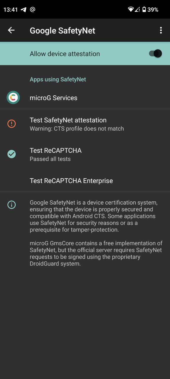

Maybe it does pass? It doesn’t specifically say yes or no but gives a warning about CTS profile does not match and I just assumed that was a fail. On the other hand it passes the CAPTCHA I just noticed
Yes it is a fail. I don’t see why
