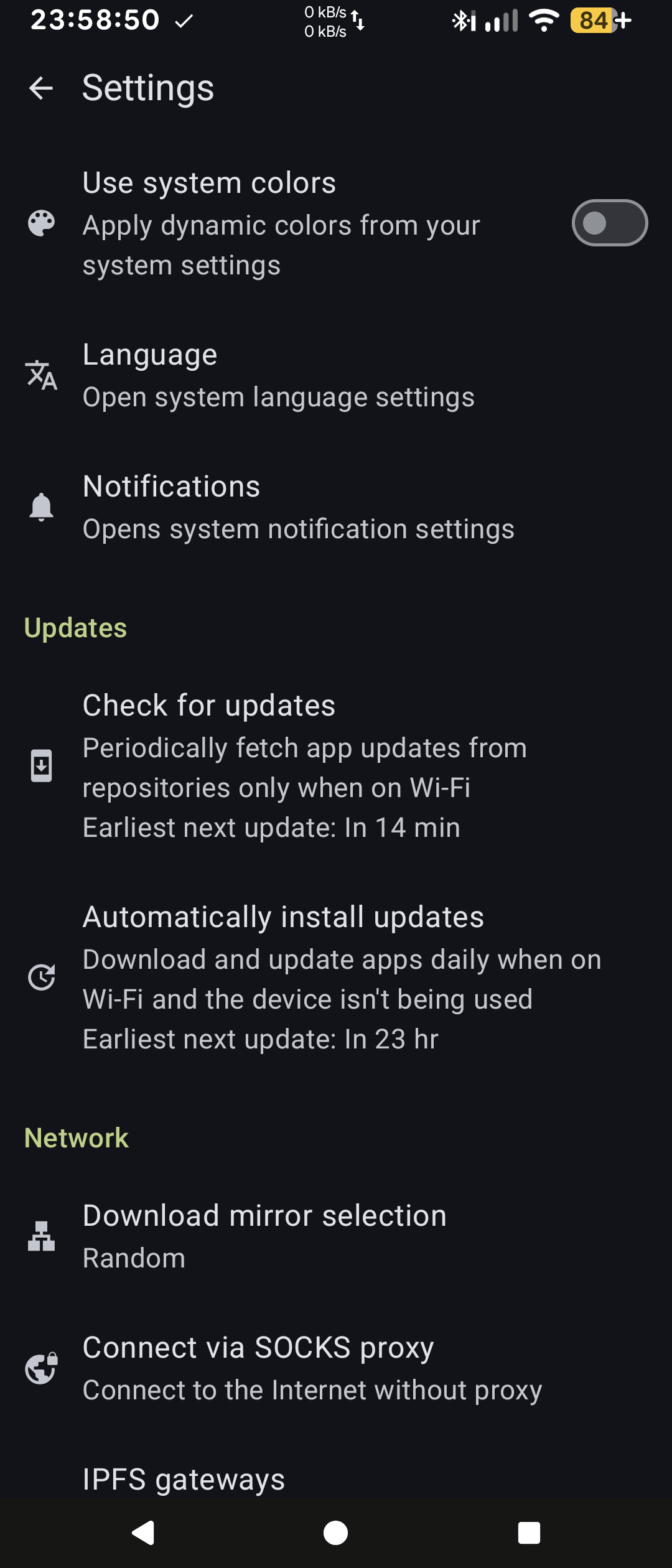

You have to switch this in the settings. Default in ioDroid is auto-update.
Thanks for this warning! I could not find the settings for this. If I go via ioDroid → long press → App Info, there seems not to be any switch for the auto-update/manual update.
Couldn’t find anything in the settings either. Maybe just being blind :sunglasses:
Thank you. The weird thing: if I search for “updates” in the settings, I only find system updates (off/manually, just as wanted) in the developer options.
Even if I am searching in German “Aktualisierung”, I find nothing.
EDIT: The cog wheel in ioDroid did the trick!
Thanks again for the hint! It is especially important since it would even download updates using mobile data (which I don’t have, but plan to buy in October, when travelling).
