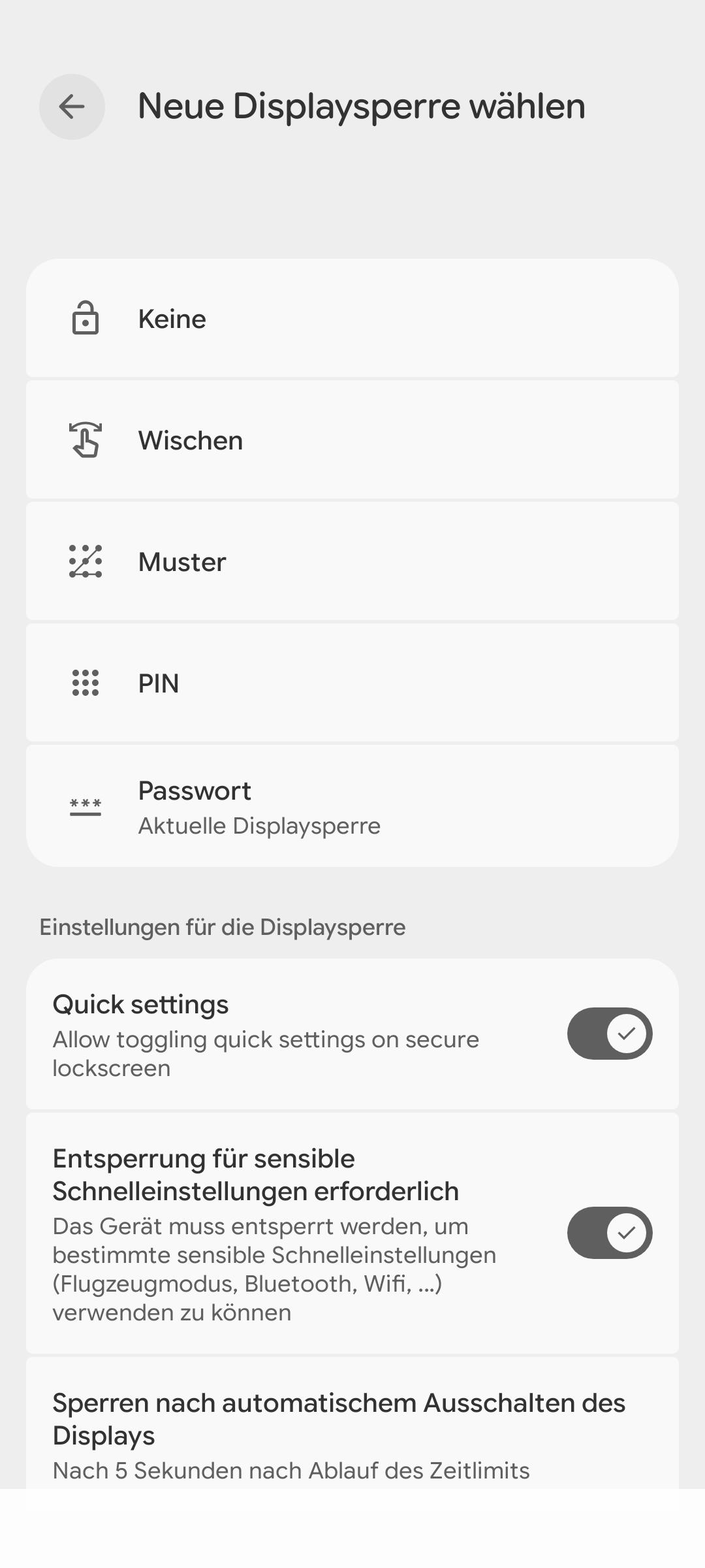

You mean still without FP sensor, right?
No. According to the changelog, fingerprint recognition now works (even with an unlocked bootloader). Work as expected → It works.
After the restart (which follows the installation), you will be asked whether you want to register it, as it is now available.
Great. Did you use the OTA install over 7.5, or a clean flash?
Edit: Did it myself via OTA. Indeed it seems to work. Thank you guys for your efforts!
