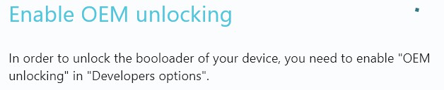

Installer stuck at "Enable OEM unlocking"
Now I want to reactivate my XA2, the installer recognizes it, USB debugging is activated in the developer options and then I should activate the boot loader. But this has already been done. This is the end of the installation.
Should I dispose of it or is there a solution?

I tried to install iode on a pixel 7a and encountered the same problem, i am stuck on the OEM unlocking! Is there already a solution to the problem? i don’t want to install it manually :slight_smile: but i also wanted to try out iode, but it isn’t a good start if the installer doesn’t work… thanks in advance

The installer needs your phone to have both “USB Debugging” and “OEM unlocking” toggled to proceed with the installation. The latter is true even when the device has already been unlocked.
If you want to bypass enable OEM unlocking (maybe because the options does not show up in the developper options), you could reboot to fastboot manually.
