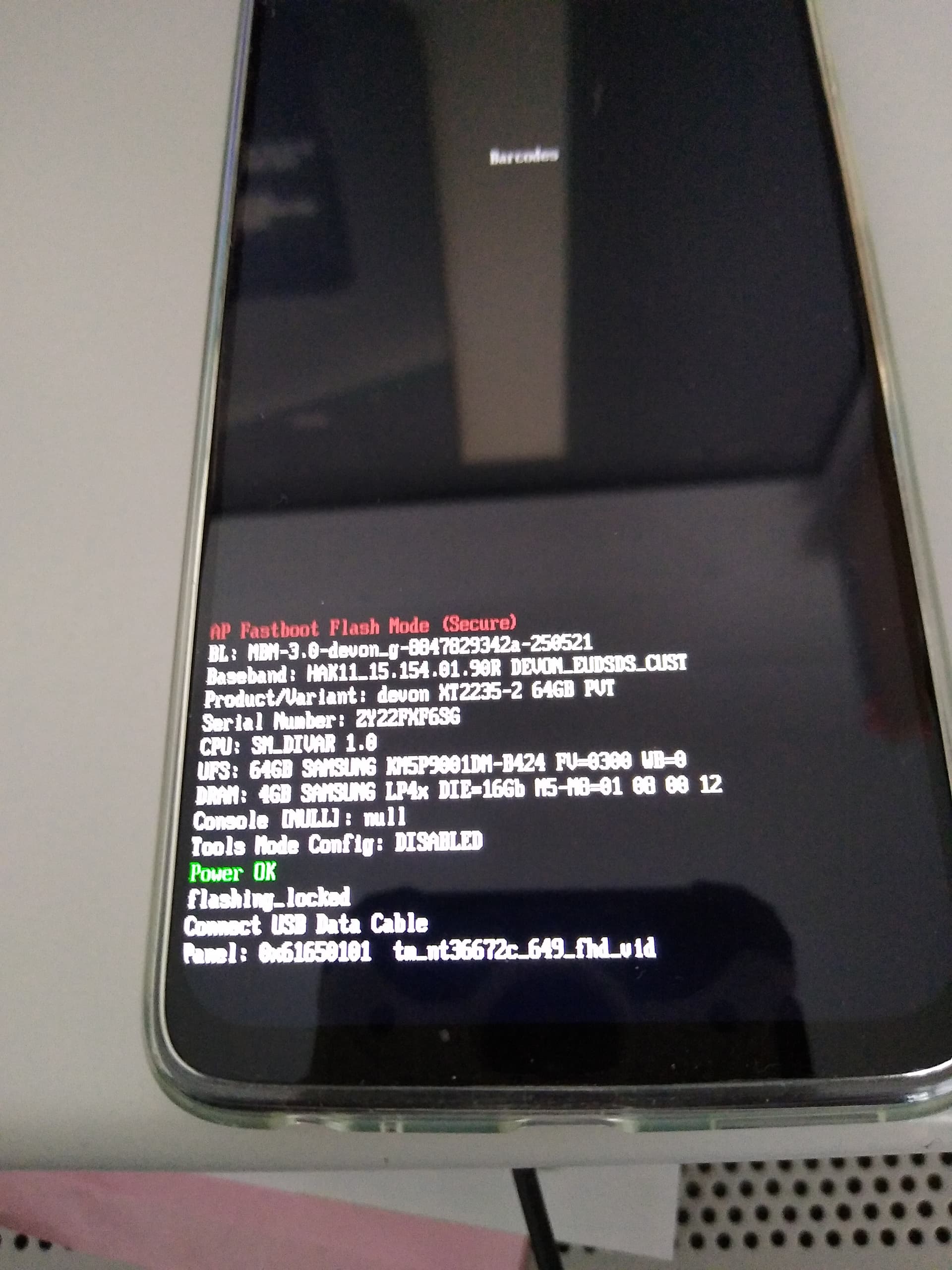

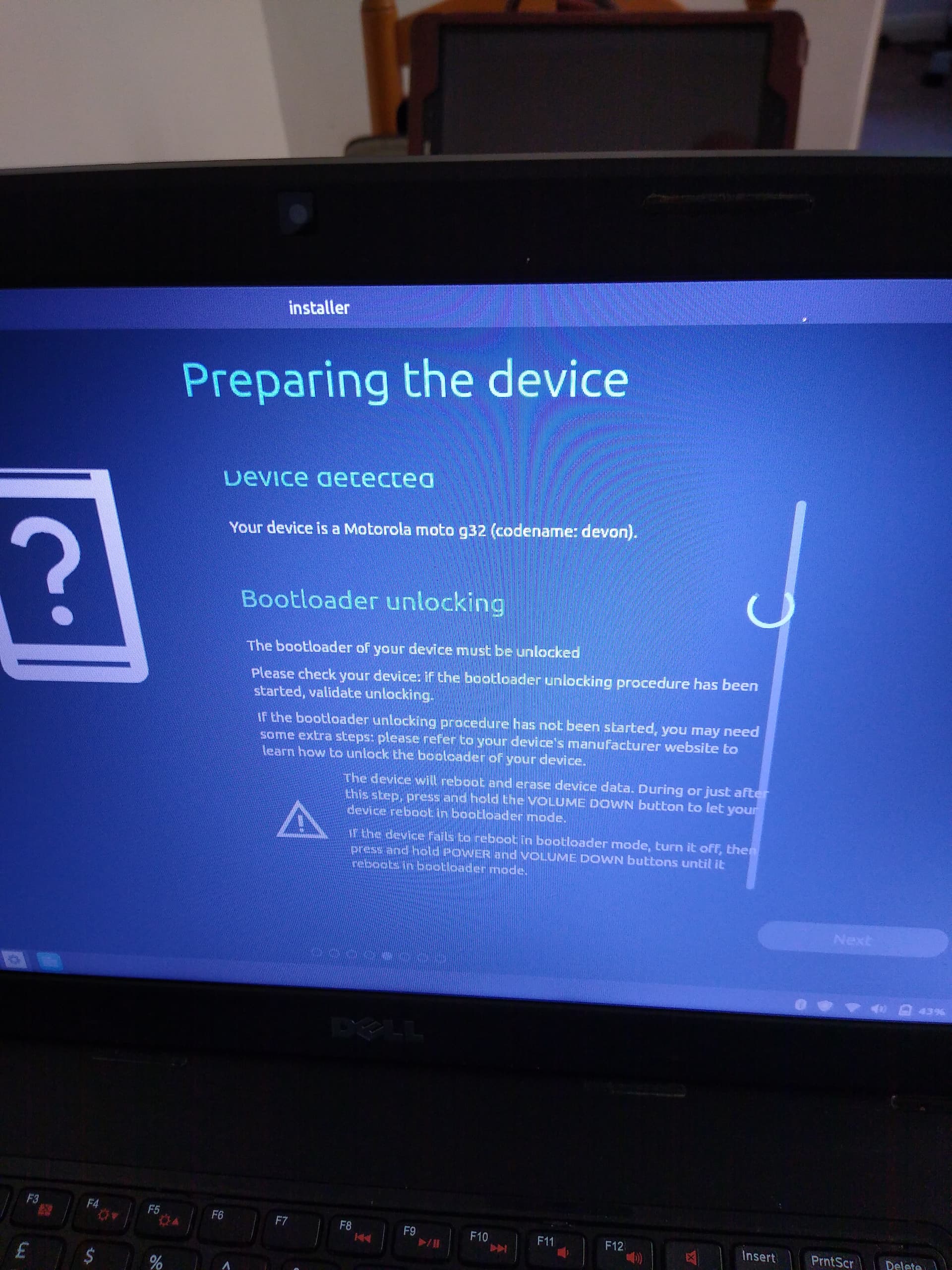

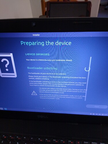

Hi, I used the installer flash iode on my G32 which ended successfully and asked whether I wanted to lock the bootloader. I guess I was a bit slow in answering so it defaulted to No and ended. The phone boots successfully into iode.
I went back into fastboot mode and used the command 'fastboot flashing lock, which seemed to succeed as it flashed a message ‘Bootloader is now locked’.

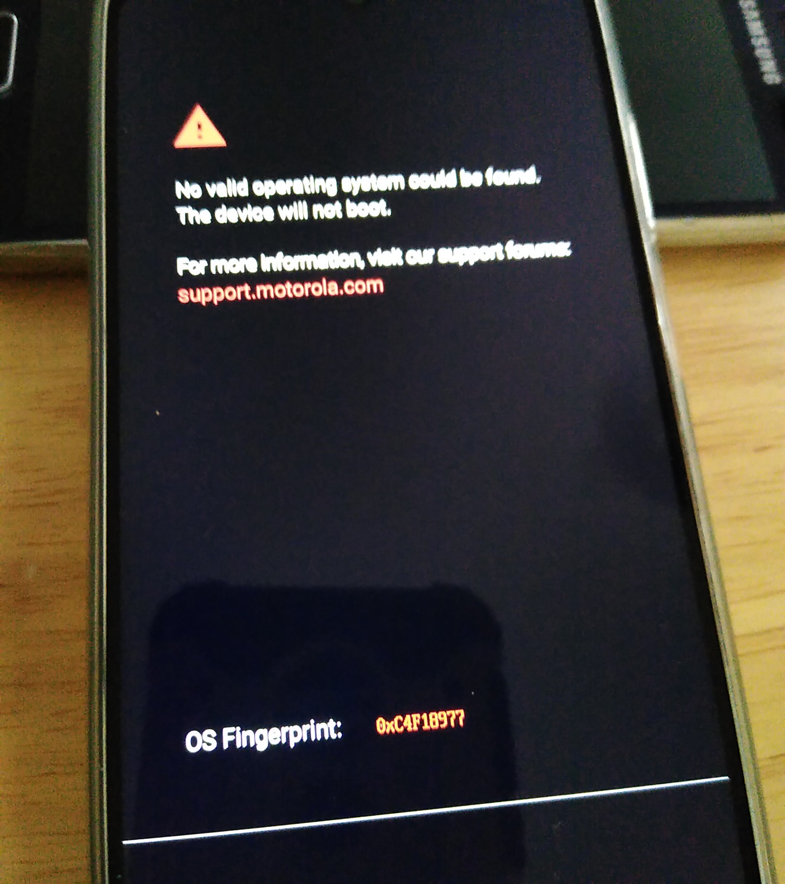

However when I reboot the phone it immediately shows a message saying ‘No valid operating system can be found on this device, The device will not boot’
Back into bootloader mode and entered ‘fastboot flashing unlock’ which ended successfully and the phone now boots.
Any idea what I’m doing wrong?

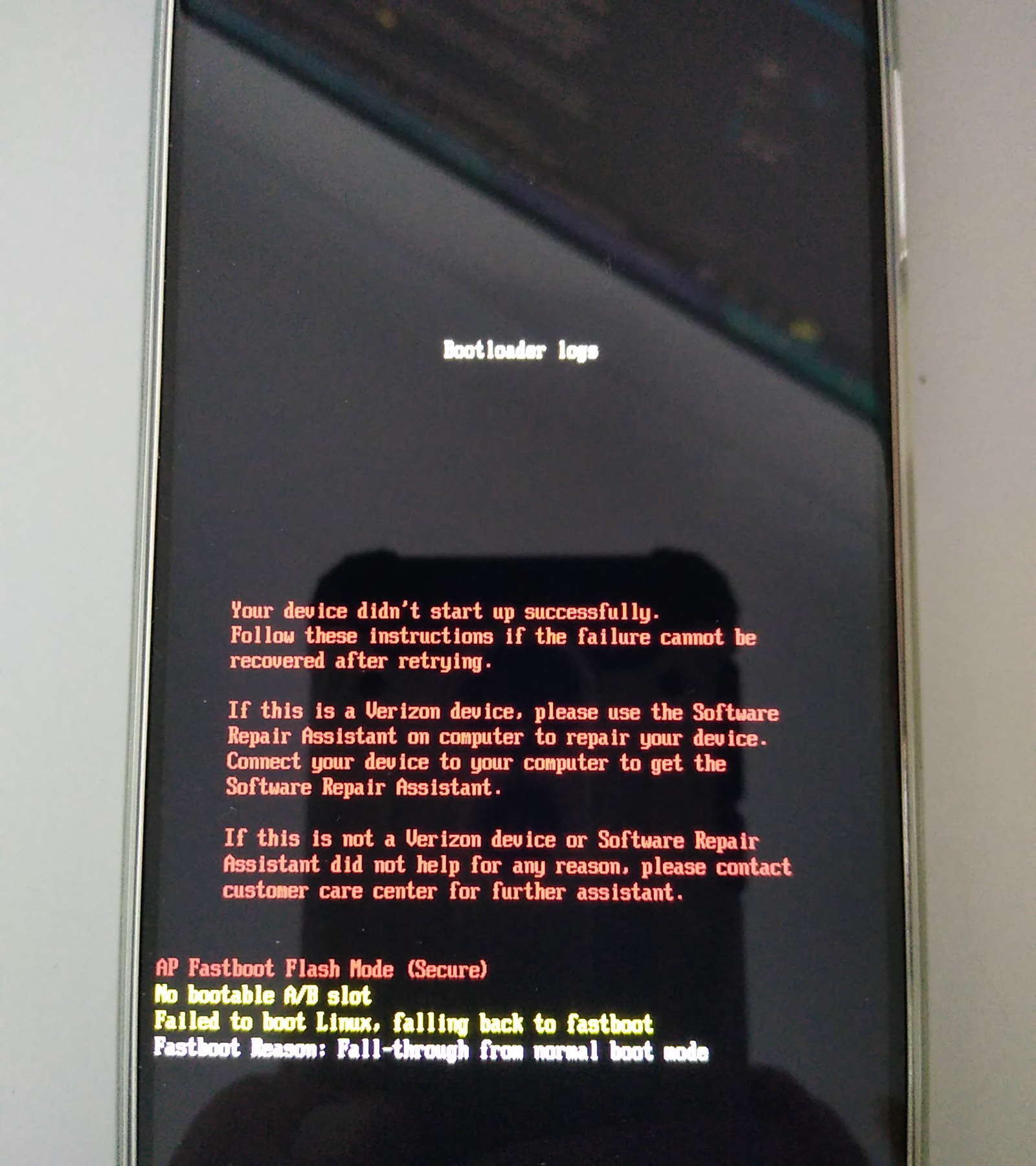

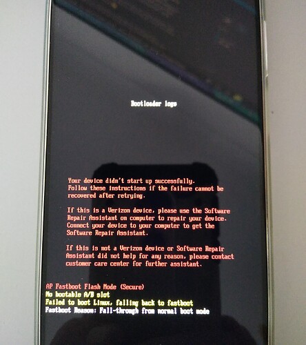

Well I ran the installation process again, this time I selected “Lock bootloader” at the end. Same result as before, the phone won’t boot.
I installed again, this time I selected bootloader unlocked. I got a message that the installation had failed but the phone nevertheless booted into iode.
Seem if I lock the bootloader my phone won’t boot. Any ideas?
Thanks

When I boot the device I get the display shown (looks like fastboot mode but different to how it looked previously) and am unable to connect to it using adb. When I try the linux flashing tool it finds the G32 Devon, asks for the unlock code but then I just get the spinning wheel , never unlocks.
Is there a way out of this?
Thanks for any help.
Sorry, forgot to add photos to the message above.
Thanks for the details, I’ll try to get some more feedback to see if the devs see anything amiss.
To your question about going back to an unlocked state, you should be able to execute the following command from your bootloader:
That will wipe out any existing userdata partition. But am wondering if this at least gets you back to booting iodéOS?
