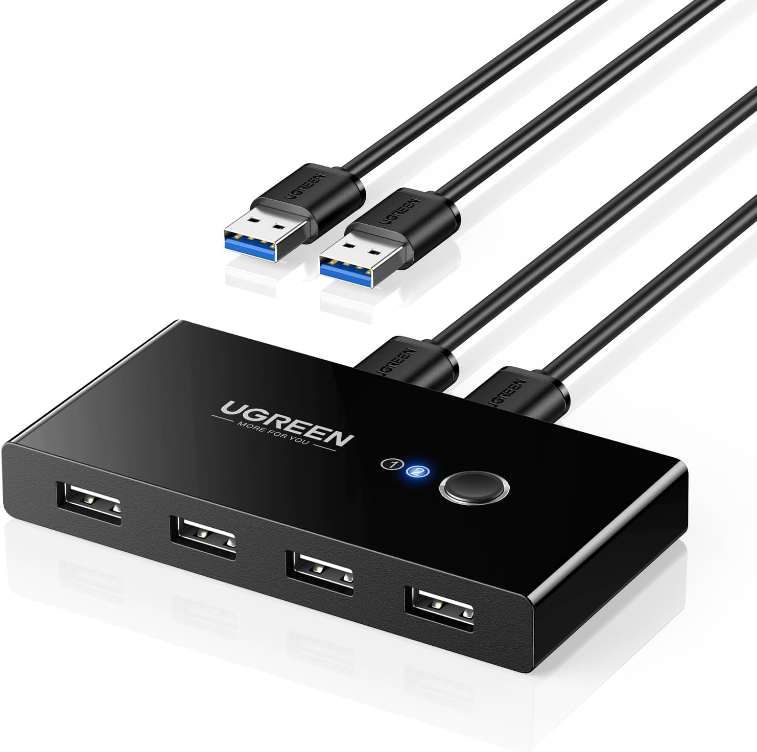

USB 3 doesnt work for flashing, really?!
I don’t have any USB 3.0 problems. Try using a USB 20 switch in between.
I just tried on Xperia XA2 and I had no problem with adb (it finds the device and I can enter the bootloader), but when I try to flash boot.img it disconnects. fastboot finds the device, but idk what goes wrong. I also tried different USB port, but I got the same error
Please report fastboot --version and what distro are you on? As it is a 32bit distro it may be quite old and thus need an updated fastboot version?
No no, the problem arises with the 64bit computer. Fastboot is 28.0.2, installed from apt on Ubuntu 22.04 distribution.
The 32bit computer is Lubuntu 18.04 and works perfectly
