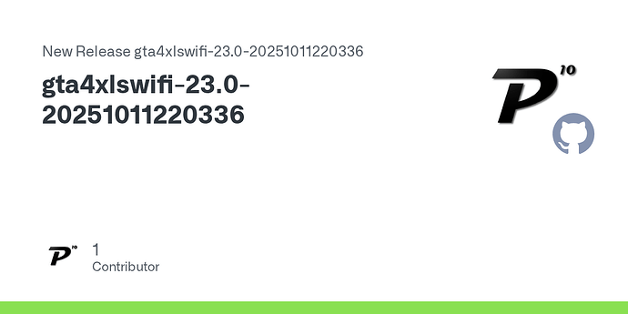

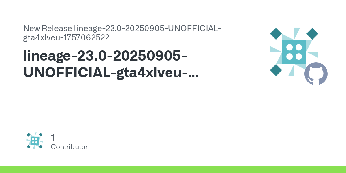

I am considering purchasing a 2022 or a 2024 Samsung Tablet S6e Lite which does not have official LOS builds. However, unofficial builds for both these exist.
and:
Is it possible to use these to make iodeOS official builds from these? Are there detailed instructions somewhere? I am a Fedora Linux user.

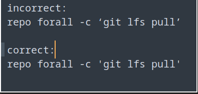

I made a build guide some time ago which also applies to iode:
I prefer repo but you can also use docker (there are build guides available too)

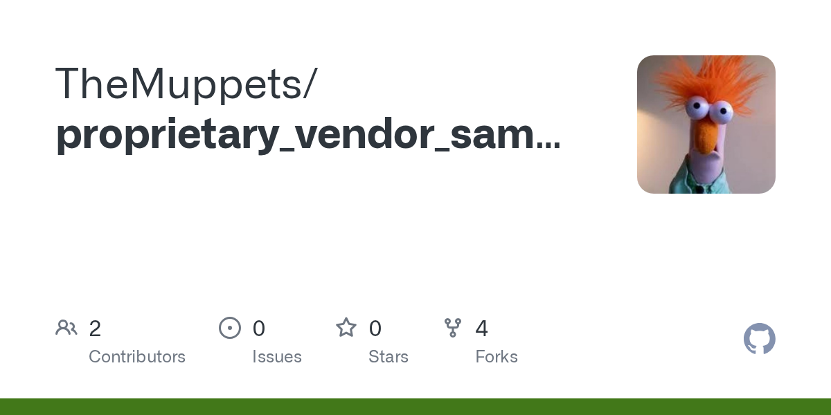

If you mean gta4xlwifi (i.e. Samsung Galaxy Tab S6 Lite (Wi-Fi)) then you don’t need to extract any files: all the files you need are in TheMuppets github repos. If you set -e “INCLUDE_PROPRIETARY=true” in your call to docker run, it will pull in all the files you need
if you use an officially supported LOS device, I take as example here gta4xlwifi - you can first type “breakfast gta4xlwifi” and then
look at theMuppets repo
For this device you need the two vendor files, but to use git clone. You can also download directly but in some cases some files due to size are not download.

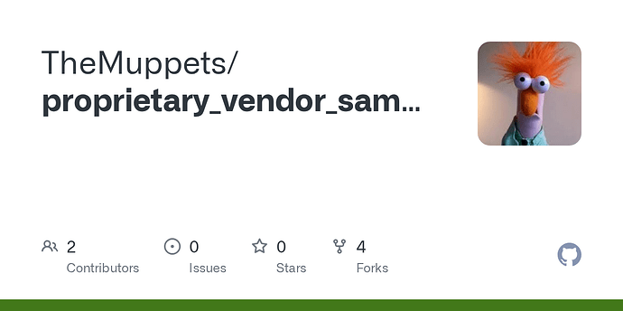

git clone GitHub - TheMuppets/proprietary_vendor_samsung_gta4xlwifi
and
git clone GitHub - TheMuppets/proprietary_vendor_samsung_gta4xl-common
and move the folders than to /vendor/samsung
now you should be able to start build via brunch gta4xlwifi
