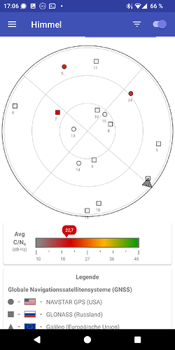

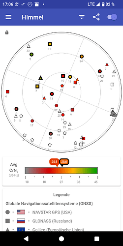

my wife and I have two identical smartphones (Fairphone 3), both running iodéOS 6.7. My smartphone does not get a fix at all or only after a long time (30 mins or more) and especially not, when I have no mobile and no wifi connection. The smartphone of my wife gets a fix usually in less than 2 minutes. I checked all settings (see this list), and these are identical. To further track down this issue, I positioned bothe phones on a table outside, started the app GPSStatus and watched what was happening - see the result in the following two screenshots:
The first one is the smartphone of my wife, the second one is my smartphone. I hit on both smartphones PSDS-Daten einspeisen and Zeit-Daten laden in the app GPSstatus.
Looking at this, I would suspect a hardware error on my phone. Any other ideas?
