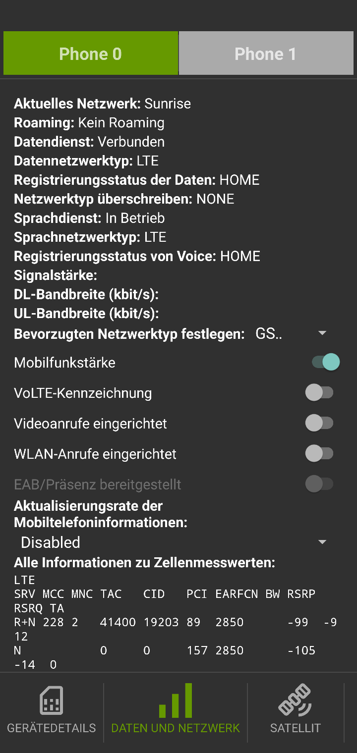

Attached is the requested screenshot of my SIM connection settings.
If this summary is accurate, then Sunrise finished shutting down its 2G and 3G networks some time ago.
With no VoLTE, and with no 2G or 3G networks to fall back to, it’s no surprise you’re having problems with calls on a Samsung.

No idea why that might be, unless there’s maybe some unpublicized residual 2G remaining in your area that your device happens to connect to under certain conditions. I’ve seen a few forum comments about problems with Sunrise on other phone brands, so it could just be a carrier quirk. (Problems also reported here.)
But you’re definitely going to have continuing issues with Samsung unless the current work-in-progress reverse engineering of their IMS code is successful.
