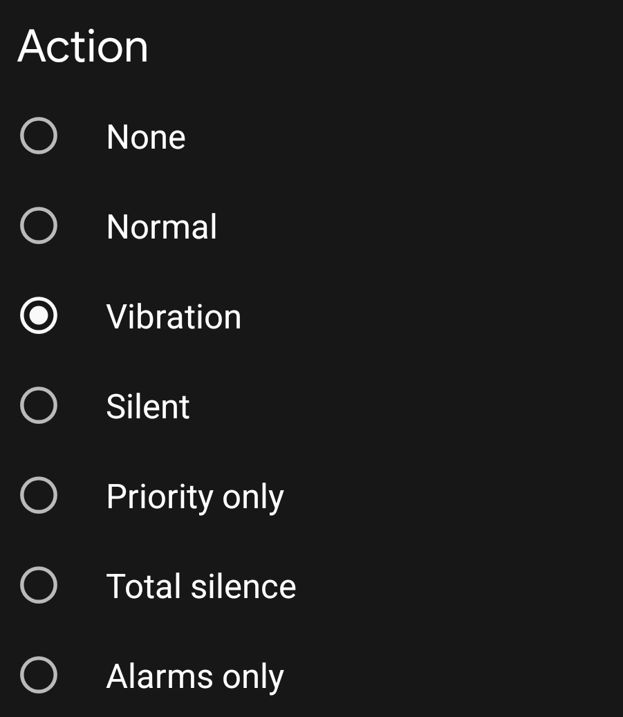

The slider is configurable, you can select the following options for the up and down position:
The Fairphone Moments function only exists on the OS that Fairphone provides.
