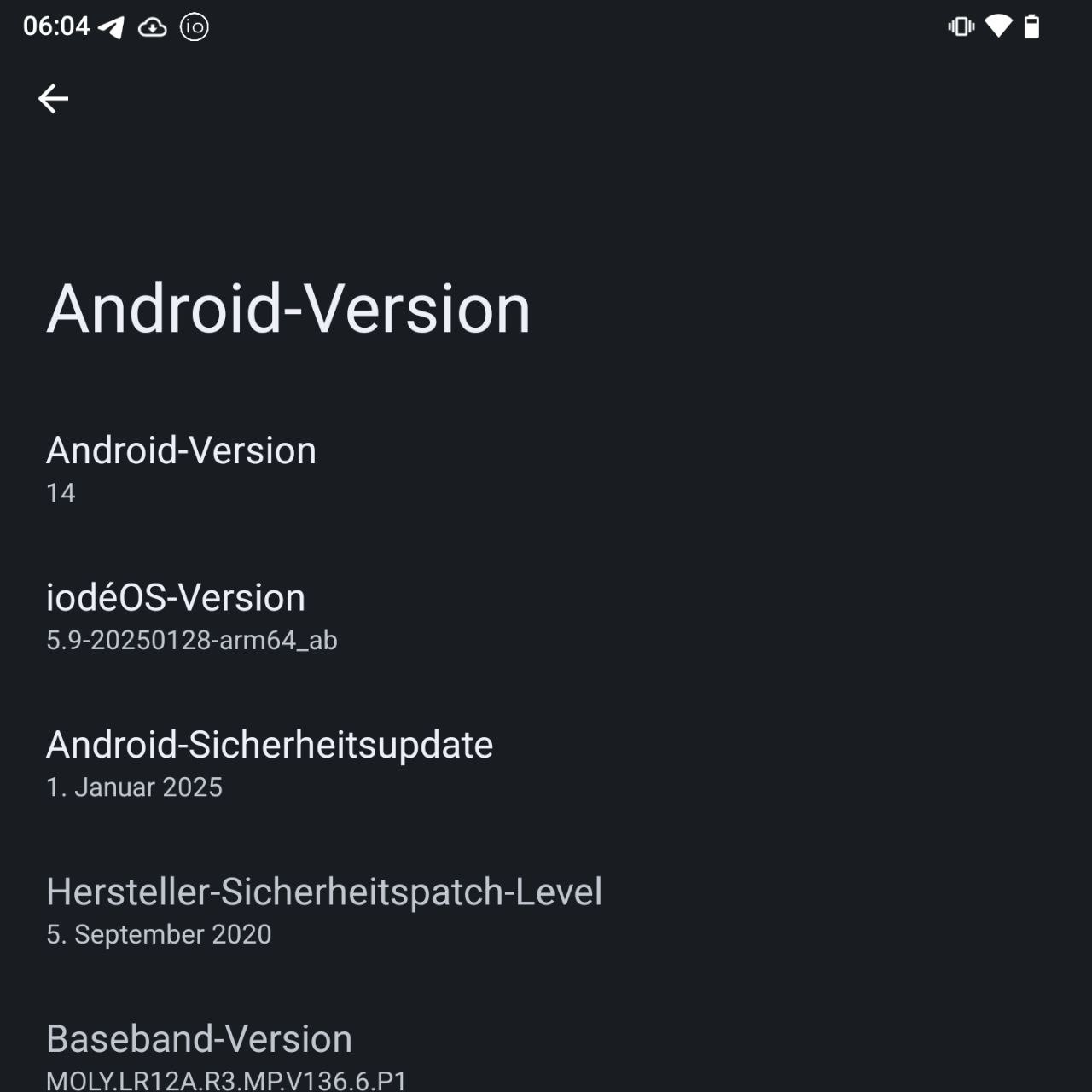

I beg your pardon. Here is the hopefully relevant information about the device:
Unihertz Titan with A10 (latest FW),
Mediatek MT6771V/C,
arm64-v8a,
Kernel 4.14.141+,
Bluetooth 4x (BLE, Peripheral Mode, Multiple adversitement, Offloaded filtering, Ofloaded scan batching, LE advertising data lengh =30),
WiFi 5 (802.11ac)
PS: I have known the “disadvantages” of GSI builds for some time and can confirm that iodéOS is one of the best builds I have tested, alongside EvolutionX (Slim, maintainer Mitja) and Gargoyle (maintainer Rumplestilzken).
