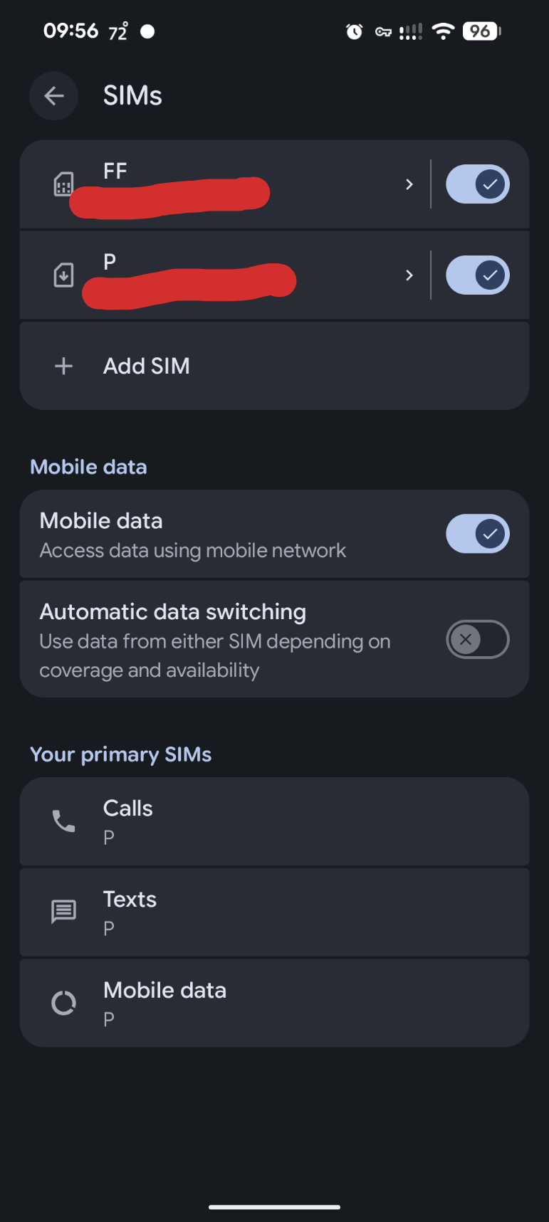

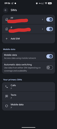

Forgive my ignorance (no experience yet with dual sim usage), but where is the setting to make primary / secondary? Inside the SIM settings?
No problem. After you add both sims, the options appear at the bottom.
Thanks! A picture says a 1000 words :slight_smile:
