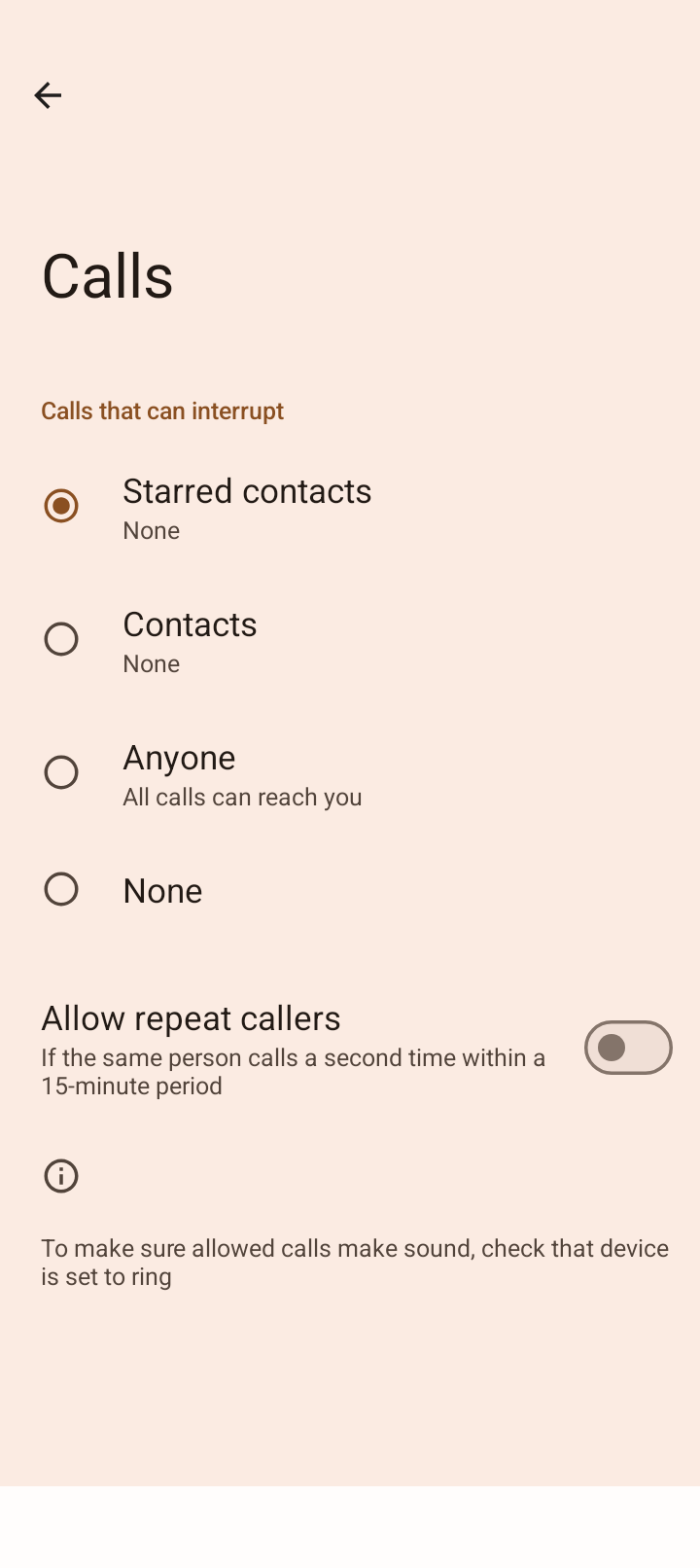

I use “Do Not Disturb” a lot especially overnight. I have “starred” a couple of contacts that I want to be able to reach me when this is set. I can see the calls coming in but the phone ringer is silent. I see mention in the “Do Not Disturb” settings “To make sure allowed calls make sound, check that device is set to ring”.
To be clear, the ringer is at full volume.
Maybe a dumb question but how do I get this to work, please?

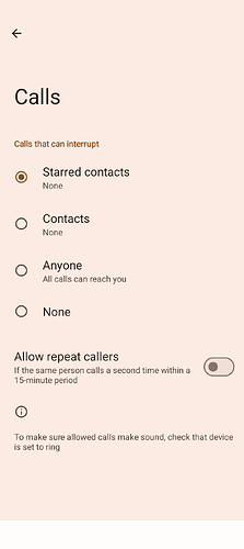

I do not see a gear setting option once I get to Starred contacts option. That might be part of the problem. I “starred” my contacts through the Fossify Contacts app. Conicidentally, under the Starred contacts and under Contacts, both are showing as None… I think you are on to something but why I cannot see the gear is a mystery. I am IODE OS 6.6-20250803-brax3. Android v15
I believe that I have finally figured this out. The clue I guess was in “None” showing up under “Starred” and “Contacts”. When I dug deeper into the individual contact information, right at the very bottom of the info it says “Phone storage (not visible by other apps”. If you click on this, you get a bubble giving options to switch between DEVICE or remain on Phone storage (not visible by other apps). I switched to DEVICE and then the contacts started appearing under the various starred or contacts categories under DND.
